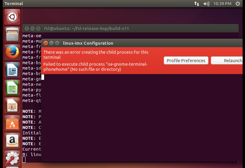

lilleli
hello community,
     I single compile kernel ,use below command,but have some prolbem:
bitbake -c menuconfig -v linux-imx
