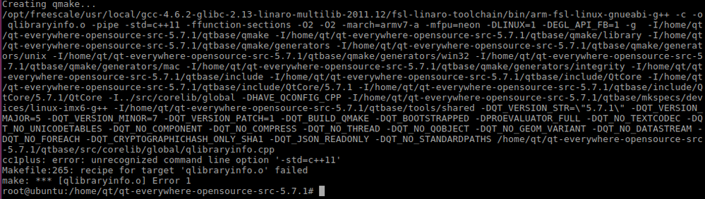

My kernel is 3.0.35uboot is 2009.08 qmake and the configure configuration is as follows
include(../../common/linux.conf)
include(../../common/gcc-base-unix.conf)
include(../../common/g++-unix.conf)
#include(../../common/qws.conf)
# modifications to g++.conf
#QMAKE_CC = arm-fsl-linux-gnueabi-gcc
#QMAKE_CXX = arm-fsl-linux-gnueabi-g++
#QMAKE_LINK = arm-fsl-linux-gnueabi-g++
#QMAKE_LINK_SHLIB = arm-fsl-linux-gnueabi-g++
QMAKE_CC = /opt/freescale/usr/local/gcc-4.6.2-glibc-2.13-linaro-multilib-2011.12/fsl-linaro-toolchain/bin/arm-fsl-linux-gnueabi-gcc
QMAKE_CXX = /opt/freescale/usr/local/gcc-4.6.2-glibc-2.13-linaro-multilib-2011.12/fsl-linaro-toolchain/bin/arm-fsl-linux-gnueabi-g++
QMAKE_LINK = /opt/freescale/usr/local/gcc-4.6.2-glibc-2.13-linaro-multilib-2011.12/fsl-linaro-toolchain/bin/arm-fsl-linux-gnueabi-g++
QMAKE_LINK_SHLIB = /opt/freescale/usr/local/gcc-4.6.2-glibc-2.13-linaro-multilib-2011.12/fsl-linaro-toolchain/bin/arm-fsl-linux-gnueabi-g++
QMAKE_LFLAGS += -W1,rpath=/work/imx6/rootfs/usr/lib
# modifications to linux.conf
#QMAKE_AR = arm-fsl-linux-gnueabi-ar cqs
#QMAKE_OBJCOPY = arm-fsl-linux-gnueabi-objcopy
#QMAKE_STRIP = arm-fsl-linux-gnueabi-strip
QMAKE_AR = /opt/freescale/usr/local/gcc-4.6.2-glibc-2.13-linaro-multilib-2011.12/fsl-linaro-toolchain/bin/arm-fsl-linux-gnueabi-ar cqs
QMAKE_OBJCOPY = /opt/freescale/usr/local/gcc-4.6.2-glibc-2.13-linaro-multilib-2011.12/fsl-linaro-toolchain/bin/arm-fsl-linux-gnueabi-objcopy
QMAKE_STRIP = /opt/freescale/usr/local/gcc-4.6.2-glibc-2.13-linaro-multilib-2011.12/fsl-linaro-toolchain/bin/arm-fsl-linux-gnueabi-strip
QMAKE_INCDIR = /work/imx6/rootfs/usr/include
QMAKE_INCDIR_OPENGL_ES2 = /work/imx6/rootfs/usr/include/GLES2
QMAKE_LIBDIR_OPENGL_ES2 = /work/imx6/rootfs/usr/lib
QMAKE_INCDIR_EGL = /work/imx6/rootfs/usr/include/EGL
QMAKE_LIBDIR_EGL = /work/imx6/rootfs/usr/lib
QMAKE_LIBDIR_GAL = /work/imx6/rootfs/usr/lib
QMAKE_INCDIR_GAL = /work/imx6/rootfs/usr/include/
QMAKE_LIBS_OPENGL_ES1 += -lGLESv1_CM -lEGL -lGAL
QMAKE_LIBS_OPENGL_ES1CL += -lGLES_CL -lEGL -lGAL
QMAKE_LIBS_EGL += -lEGL -lGAL
QMAKE_LIBS_OPENGL_ES2 += -lGLESv2 -lEGL -lGAL
QMAKE_LIBS_OPENVG += -lOpenVG -lEGL -lGAL
IMX6_CFLAGS = -march=armv7-a -mfpu=neon -DLINUX=1 -DEGL_API_FB=1
IMX6_CFLAGS_RELEASE = -O2 $$IMX6_CFLAGS
QMAKE_CFLAGS_RELEASE += $$IMX6_CFLAGS_RELEASE
QMAKE_CXXFLAGS_RELEASE += $$IMX6_CFLAGS_RELEASE
QMAKE_CFLAGS_DEBUG += $$IMX6_CFLAGS
QMAKE_CXXFLAGS_DEBUG += $$IMX6_CFLAGS
./configure \
-v \
-prefix /home/qt/qt5.7.1 \
-release \
-opensource \
-no-accessibility \
-make libs \
-device linux-imx6-g++ \
-device-option CROSS_COMPILE=/opt/freescale/usr/local/gcc-4.6.2-glibc-2.13-linaro-multilib-2011.12/fsl-linaro-toolchain/bin/arm-fsl-linux-gnueabi- \
-optimized-qmake \
-c++std c++1z \
-pch \
-qt-sql-sqlite \
-qt-zlib \
-tslib \
-no-opengl \
-no-sse2 \
-no-openssl \
-no-cups \
-no-glib \
-no-pkg-config \
-no-separate-debug-info \
-I/home/qt/ts/include -L/home/qt/ts/lib
In the existing cross compiler tool version is 4.6.2 compiler QT5.7.1 out the following problems to be solved, if the cross tool version is too low to solve
