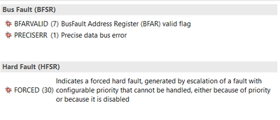

we have a bootloader that performs a simple jump to a certain address in the flash, it works perfectly fine with the debug image (axf) but with release without changing anything we get these errors:

That happens at moment of compiling or happens when you try the program on the board, since the error log is from your debugger I mean you miss something in the process.

OM120
it happens when running the program right after calling the jump function

Bio_TICFSL
I can not reproduce it here, but you might build your code again without debug symbols.

OM120
by "build your code again without debug symbols." do you mean to change debug level to none ?
