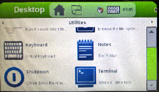

lavakumars
hi thanks all ,
for your reply. now I am able to build the fsl-image-qt5 image . but in the display I am getting only the qt5 app. want to work with terminal and other apps .
Please let me know how to set that up..?
and in the hyper terminal in the boot menu I am asked to enter user name and password please let me know where can I find the credentials.
regards,
Lavakumar S
7,490 Views
jan_spurek
as for the credentials, the user name is root and no password should be required.
What do you mean by "the qt5 app"? After boot, a green-white coloured environment should appear and all apps should be there.
Like this:
7,489 Views
lavakumars
Thanks Jan Spurek
yes I got it.. actually the remaining apps are in the side windows...
7,489 Views
