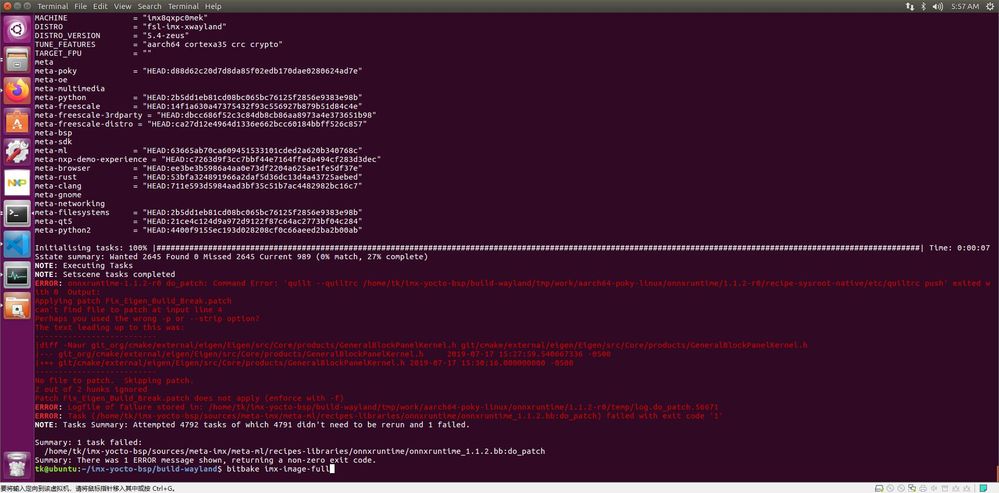

Dear Sir or Madam,
When I build MIMX8QX project with 'bitbake imx-image-full', I meet the errors below. I'm sure that 'repo sync' has succeeded, and I also delete the /tmp & /sstate-cache two folders and bitbake again. Unfortunately, I always meet this problem. Can you help me with this query?Thank you in anticipation for your kindly help!!

Sstate summary: Wanted 2645 Found 0 Missed 2645 Current 989 (0% match, 27% complete)
NOTE: Executing Tasks
NOTE: Setscene tasks completed
ERROR: onnxruntime-1.1.2-r0 do_patch: Command Error: 'quilt --quiltrc /home/tk/imx-yocto-bsp/build-wayland/tmp/work/aarch64-poky-linux/onnxruntime/1.1.2-r0/recipe-sysroot-native/etc/quiltrc push' exited with 0 Output:
Applying patch Fix_Eigen_Build_Break.patch
can't find file to patch at input line 4
Perhaps you used the wrong -p or --strip option?
The text leading up to this was:
|diff -Naur git_org/cmake/external/eigen/Eigen/src/Core/products/GeneralBlockPanelKernel.h git/cmake/external/eigen/Eigen/src/Core/products/GeneralBlockPanelKernel.h
|--- git_org/cmake/external/eigen/Eigen/src/Core/products/GeneralBlockPanelKernel.h 2019-07-17 15:27:59.540667336 -0500
|+++ git/cmake/external/eigen/Eigen/src/Core/products/GeneralBlockPanelKernel.h 2019-07-17 15:30:16.000000000 -0500
No file to patch. Skipping patch.
2 out of 2 hunks ignored
Patch Fix_Eigen_Build_Break.patch does not apply (enforce with -f)
ERROR: Logfile of failure stored in: /home/tk/imx-yocto-bsp/build-wayland/tmp/work/aarch64-poky-linux/onnxruntime/1.1.2-r0/temp/log.do_patch.56671
ERROR: Task (/home/tk/imx-yocto-bsp/sources/meta-imx/meta-ml/recipes-libraries/onnxruntime/onnxruntime_1.1.2.bb:do_patch) failed with exit code '1'
NOTE: Tasks Summary: Attempted 4792 tasks of which 4791 didn't need to be rerun and 1 failed.
Summary: 1 task failed:
Summary: There was 1 ERROR message shown, returning a non-zero exit code.
