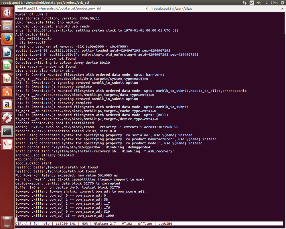

Hi All,
I have downloaded Android Lollipup v5.1.1 for i.MX6 Sololite, and flashed it  on to the card and booted, I observed that some binder is failing.
PFA by name error_after_booting.jpg, and while flashing the card it says /dev/sdb5 is not a block special device  PFA  by name while_flashing.png.
This issue is not seen while flashing with Android 4.4.3 earlier.
Please help me to proceed further.

Please find the image for the above post in which command line is not accessible.

Hi vikas,
System image is not mounted.
This is my log:
Below 2 line is not coming in your log.
EXT4-fs (mmcblk3p5): mounted filesystem with ordered data mode. Opts: barrier=1
fs_mgr: __mount(source=/dev/block/mmcblk3p5,target=/system,type=ext4)=0
EXT4-fs (mmcblk3p4): Ignoring removed nomblk_io_submit option
EXT4-fs (mmcblk3p4): mounted filesystem with ordered data mode. Opts: nomblk_io_submit,noauto_da_alloc,errors=panic
fs_mgr: __mount(source=/dev/block/mmcblk3p4,target=/data,type=ext4)=0
EXT4-fs (mmcblk3p6): Ignoring removed nomblk_io_submit option
EXT4-fs (mmcblk3p6): mounted filesystem with ordered data mode. Opts: nomblk_io_submit
fs_mgr: __mount(source=/dev/block/mmcblk3p6,target=/cache,type=ext4)=0
EXT4-fs (mmcblk3p7): mounted filesystem with ordered data mode. Opts: (null)
fs_mgr: __mount(source=/dev/block/mmcblk3p7,target=/device,type=ext4)=0
init: Starting service 'logd'...
Hope above information is helpful for you!
