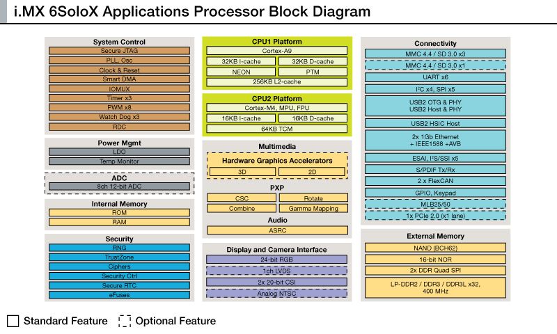

Hi everyone,
I have UDOO NEO FULL board with the imx6sx chip in it. My task is to make a mobile robot using three DC motor and quadrature encoder for each one with FreeRTOS BSP.
from the diagram below, I can see that there are 8xPWM and 3xTimer in "System Control" block.
For my project, I need at least 6 PWM for three motors and 6 input capture interrupts to read three quadrature encoders data, but I still don't know how to access those peripherals using FreeRTOS BSP package and I don't see any example for this kind of task.
Did I miss something or anyone here knows how to access PWM and generate input capture interrupts in FreeRTOS BSP?

Hi Andra,
From the hardware side, the 3 timers mentioned on the block diagram, corresponds to two Enhanced Periodic Interrupt Timers (EPIT1 and EPIT2) and one General Purpose Timer (GPT).
The GPT is the one with Input Capture features, but it just has 2 inputs (GPT_CAPTURE1 and GPT_CAPTURE2).
Regarding PWM, there are 8 independent PWM timers (PWM-1 … PWM-8) that could be used separately.
From the software side, you could refer to the API Reference Manual of FreeRTOS BSP packages, available for download from the “Board Support Packages” section of the following link:
https://www.nxp.com/support/developer-resources/hardware-development-tools/sabre-development-system/...

but now I am facing a problem with the FreeRTOS BSP Documentation, it seems that there are no example or documentation about generating PWM from the M4 side. Do you know anything about that?
