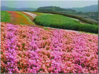

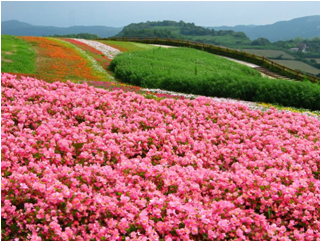

GaoJianzhong
I use linux_topdir/driver/media/video/mxc/capture/adv7180.c and capture data from adv7180.
The input of adv7180 is NTSC data.
below is the input data to adv7180:
But my captured data is:
There are 4,5 lines on picture.
Note that this test is on the default linux BSP of AI board, and i do not make any changes.
I think you can also reproduce this on your freescale AI board.
