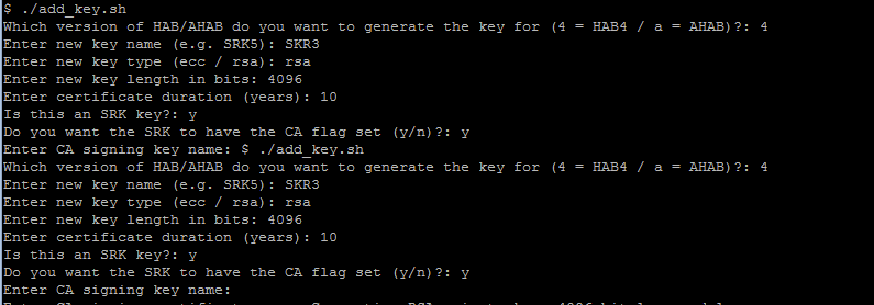

I am using script add_key.sh to add a new SRK key ( SRK3 ) to an already done PKIT tree containing 2 SRK keys ( SRK1 and SRK2 ).
I answer the questions as follow :
Which version of HAB/AHAB do you want to generate the key for (4 = HAB4 / a = AHAB)?: 4
Enter new key name (e.g. SRK5): SRK3
Enter new key type (ecc / rsa): rsa
Enter new key length in bits: 4096
Enter certificate duration (years): 10
Is this an SRK key?: yes
Enter SRK signing key name: ..path..CA1_sha256_4096_65537_v3_ca_key.pem
Enter SRK signing certificate name: ..path..CA1_sha256_4096_65537_v3_ca_crt.pem
Generating RSA private key, 4096 bit long modulus (2 primes)
SRK3 private/public key pair is generated.
Now I try generating theSRK table and the fuse map with the 3 SRK keys ( 2 SRK keys added when builing the PKI tree at the beginning and this SRK3 key just added ).
I get the error message :
[ERROR] SRKTOOL: All certificates must be either CA or user certs
Why does this happen ?

antonio_santagi
Ok.
Now I found why it didn't ask that question of CA flag set to me, it's because I replied with 'yes' instead of with 'y' to previous question 'Is this an SRK key?: yes'   .
if I reply with 'y' now I see that it asks if I want CA flag set. Problem was simple.

antonio_santagi
Ok.
