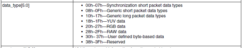

According to Figure 19-6. RGB666 data reception in IMX6DQRM(Rev.3), MIPI CSI2 can receive data in RGB666 format.
But according to register of IPUx_CSI0_SENS_CONF, it looks like that the IPU CSI cannot receive RGB666 data.
Could you explain it for me?
Q2)
According to Table 19-1. Input signals to CSI2IPU ,data_type for RGB data is 0x20~0x27.So when data format is RGB666,the data_type is what? And how to set it?

1. you are right, not all MIPI CSI2 formats are supported by IPU.
2. according to MIPI-CSI2 specification (Version 1.01.00 9-Nov-2010) Table 16
RGB666 data_type =0x23 . These data is set by transmitter (sensor) in packet header .

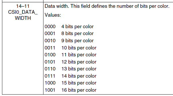

About generic data, I have two questions.
Q1)
If set CSI0_SENS_DATA_FORMAT to generic data, then how to set CSI0_DATA_WIDTH?
Q2)
If RGB666 input is received as generic data ,then how to resolve it back to RGB666 format(Need I write some custom code)?
