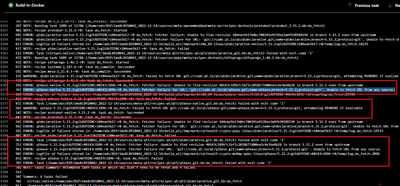

Hi NXP
Our customer recently feedback build fail in Yocto 3.3_5.10.35 and Yocto 3.3_5.10.72.
I try to check and build demo board imx8mm imx8mp in Yocto 3.3 (5.10.35 /5.10.72).
I get the same fail result with my customer.
Please help to check the fail issue as soon as possible. Thanks.
In 2022_Sep and 2022_Oct, compiler is success.    In 2022_12, compiler is fail.
***  ps: We Try compiler yocto in Azure VM (The Cloud VM). I think so it is not network issue.
2022-12-14T12:27:00.6445999Z ERROR: qtdeclarative-native-5.15.2+gitAUTOINC+104eae5b17-r0 do_fetch: Fetcher failure: Unable to find revision 104eae5b17b0ec700391e9539ee3a4f638588194 in branch 5.15.2 even from upstream
2022-12-14T12:27:00.6461693Z ERROR: qtdeclarative-native-5.15.2+gitAUTOINC+104eae5b17-r0 do_fetch: Fetcher failure for URL: 'git://code.qt.io/qt/qtdeclarative.git;name=qtdeclarative;branch=5.15.2;protocol=git'. Unable to fetch URL from any source.
2022-12-14T12:27:00.6560061Z ERROR: Logfile of failure stored in: /home/adv/BSP/imx8LBV10042_2022-12-14/build_all/tmp/work/x86_64-linux/qtdeclarative-native/5.15.2+gitAUTOINC+104eae5b17-r0/temp/log.do_fetch.18235
2022-12-14T12:27:00.6566747Z NOTE: recipe qtdeclarative-native-5.15.2+gitAUTOINC+104eae5b17-r0: task do_fetch: Failed
2022-12-14T12:27:00.6573652Z ERROR: Task (virtual:native:/home/adv/BSP/imx8LBV10042_2022-12-14/sources/meta-qt5/recipes-qt/qt5/qtdeclarative_git.bb:do_fetch) failed with exit code '1'

2022-12-14T12:27:23.2724423Z WARNING: qtdeclarative-5.15.2+gitAUTOINC+104eae5b17-r0 do_fetch: Failed to fetch URL git://code.qt.io/qt/qtdeclarative.git;name=qtdeclarative;branch=5.15.2;protocol=git, attempting MIRRORS if available
2022-12-14T12:28:42.4423943Z NOTE: recipe e2fsprogs-1.46.1-r0: task do_fetch: Succeeded
2022-12-14T12:29:02.1947529Z ERROR: qtbase-native-5.15.2+gitAUTOINC+40143c189b-r0 do_fetch: Fetcher failure: Unable to find revision 40143c189b7c1bf3c2058b77d00ea5c4e3be8b28 in branch 5.15.2 even from upstream
2022-12-14T12:29:02.1949439Z ERROR: qtbase-native-5.15.2+gitAUTOINC+40143c189b-r0 do_fetch: Fetcher failure for URL: 'git://code.qt.io/qt/qtbase.git;name=qtbase;branch=5.15.2;protocol=git'. Unable to fetch URL from any source.
2022-12-14T12:29:02.1960410Z ERROR: Logfile of failure stored in: /home/adv/BSP/imx8LBV10042_2022-12-14/build_all/tmp/work/x86_64-linux/qtbase-native/5.15.2+gitAUTOINC+40143c189b-r0/temp/log.do_fetch.29546
2022-12-14T12:29:02.1961802Z NOTE: recipe qtbase-native-5.15.2+gitAUTOINC+40143c189b-r0: task do_fetch: Failed
2022-12-14T12:29:02.1978703Z ERROR: Task (/home/adv/BSP/imx8LBV10042_2022-12-14/sources/meta-qt5/recipes-qt/qt5/qtbase-native_git.bb:do_fetch) failed with exit code '1'
2022-12-14T12:29:45.7656956Z WARNING: qtbase-5.15.2+gitAUTOINC+40143c189b-r0 do_fetch: Failed to fetch URL git://code.qt.io/qt/qtbase.git;name=qtbase;branch=5.15.2;protocol=git, attempting MIRRORS if available
2022-12-14T12:30:58.6282114Z NOTE: recipe protobuf-native-3.15.2-r0: task do_fetch: Succeeded
2022-12-14T12:30:58.6547644Z NOTE: recipe protobuf-3.15.2-r0: task do_fetch: Succeeded
2022-12-14T12:32:36.8377014Z ERROR: qtdeclarative-5.15.2+gitAUTOINC+104eae5b17-r0 do_fetch: Fetcher failure: Unable to find revision 104eae5b17b0ec700391e9539ee3a4f638588194 in branch 5.15.2 even from upstream
2022-12-14T12:32:36.8378196Z ERROR: qtdeclarative-5.15.2+gitAUTOINC+104eae5b17-r0 do_fetch: Fetcher failure for URL: 'git://code.qt.io/qt/qtdeclarative.git;name=qtdeclarative;branch=5.15.2;protocol=git'. Unable to fetch URL from any source.
2022-12-14T12:32:36.8388616Z ERROR: Logfile of failure stored in: /home/adv/BSP/imx8LBV10042_2022-12-14/build_all/tmp/work/cortexa53-crypto-poky-linux/qtdeclarative/5.15.2+gitAUTOINC+104eae5b17-r0/temp/log.do_fetch.19515
2022-12-14T12:32:36.8389440Z NOTE: recipe qtdeclarative-5.15.2+gitAUTOINC+104eae5b17-r0: task do_fetch: Failed
2022-12-14T12:32:36.8406896Z ERROR: Task (/home/adv/BSP/imx8LBV10042_2022-12-14/sources/meta-qt5/recipes-qt/qt5/qtdeclarative_git.bb:do_fetch) failed with exit code '1'
2022-12-14T12:45:03.5817171Z ERROR: qtbase-5.15.2+gitAUTOINC+40143c189b-r0 do_fetch: Fetcher failure: Unable to find revision 40143c189b7c1bf3c2058b77d00ea5c4e3be8b28 in branch 5.15.2 even from upstream
2022-12-14T12:45:03.5818396Z ERROR: qtbase-5.15.2+gitAUTOINC+40143c189b-r0 do_fetch: Fetcher failure for URL: 'git://code.qt.io/qt/qtbase.git;name=qtbase;branch=5.15.2;protocol=git'. Unable to fetch URL from any source.
2022-12-14T12:45:03.5827790Z ERROR: Logfile of failure stored in: /home/adv/BSP/imx8LBV10042_2022-12-14/build_all/tmp/work/cortexa53-crypto-mx8mp-poky-linux/qtbase/5.15.2+gitAUTOINC+40143c189b-r0/temp/log.do_fetch.2096
2022-12-14T12:45:03.5828665Z NOTE: recipe qtbase-5.15.2+gitAUTOINC+40143c189b-r0: task do_fetch: Failed
2022-12-14T12:45:03.5849170Z ERROR: Task (/home/adv/BSP/imx8LBV10042_2022-12-14/sources/meta-qt5/recipes-qt/qt5/qtbase_git.bb:do_fetch) failed with exit code '1'
2022-12-14T12:45:05.3877670Z NOTE: Tasks Summary: Attempted 1889 tasks of which 561 didn't need to be rerun and 4 failed.

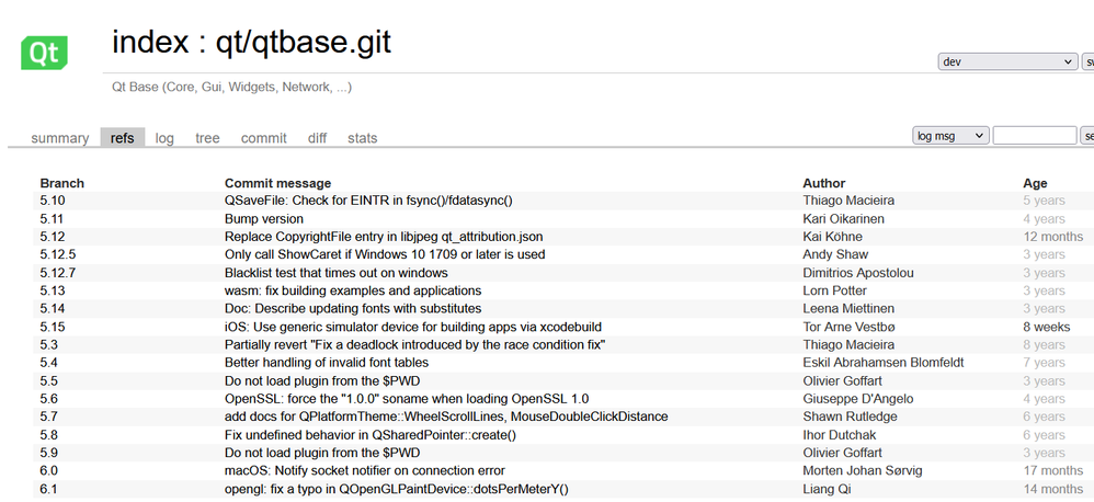

weikeng-jimmy
Hi Sir,
    QT git server look like not have 5.15.2 branch for download . You should use another branch or modify recipes for correct branch number.
