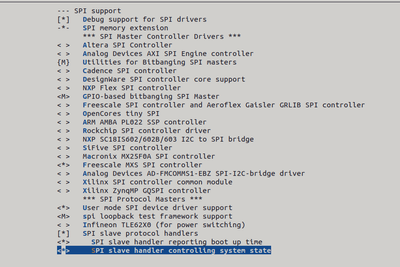

Thank you for the documents, unfortunately the spidev is not working. I have spent many hours on this effort to no avail. I have included the dts and dtsi files as a reference, any suggestions to resolve this are greatly appreciated.
SPI user mode enabled in the kernel.
ls /dev/spidev*
/dev/spidev1.1 /dev/spidev2.0

Please make sure the below-mentioned configurations are in the kernel configuration file.
CONFIG_PROC_DEVICETREE=y
CONFIG_PROC_FS=y
CONFIG_OF=y
From the previously mentioned logs, it seems that SPI is correctly initialized.
