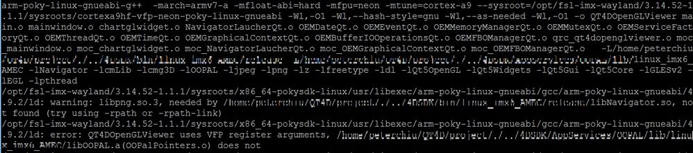

Excuse me, I have an problem, I consult Freescale Yocto Project User's Guide (L3.14.52_1.1.0), and build the "meta-toolchain-qt5".
I use the toolcahin to cross compile my qt application (HelloWorld).
It's success, the Helloworld application is work in my imx6q board.

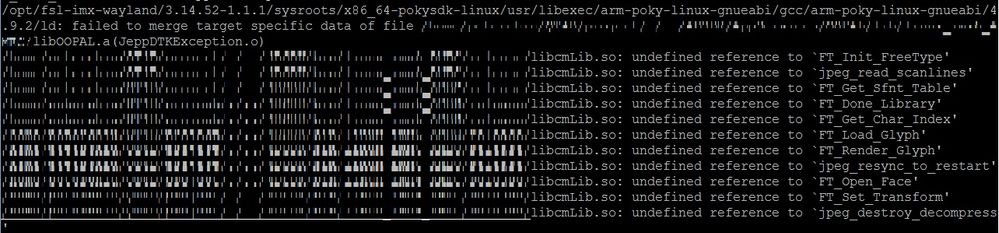

But, when  I cross compile the other qt application, it's not ok.
I got the error log:
The toolchain is use L3.14.52 to build, qt version is 5.5.
The qt application is use qt 5.4.
If anyone know what's the problem?
Please tell me. Thanks.

Hello Peter Chiu,
It seems that the problem is related to link errors to libraries needed to compile rather to the toolchain itself. I would recommend looking at the libraries and .h and making sure they are referenced correctly.
