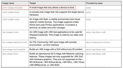

Hello All,
I have used Yocto to build to images. core-image-minimal and imx-image-core. Searching through the recipes and layers I see that many SSH implementations are included.
I have booted my device and used a terminal to verify it boots. Using the "help" command I get a list of available commands. However "ifconfig" and "ip" are not there as I would expect. The commands I do have are in the list below.
This list came from the core-image-minimal build. I am flashing the device with the imx-image-core image. However looking into the layers and recipes (in the conf files) they appear to be the same. Is there a setting or minimum image I have to build to get basic SSH functionality?

The core-image-minimal only support device boot.So there will be no ethernet function.You should try imx-image-multimedia or imx-image-full.The ssh function has been included in these two image.

I see that description but I find it confusing as the OpenSSH, SSHLib and more are included in the sources, downloads and recipes.
I just finished an fsl-image-machine-test build and I am able to read an IP address. Is there a place that lists what features are available to each image build?
Also if the SSH and Networking sources are included in the minimal build, why are they not "turned on".
