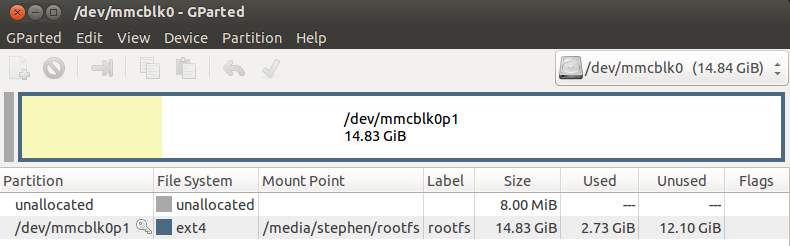

I am a bit uncertain as to how my SD card should be partitioned for use with the Yocto images.
The partitions on the SD card with the L3.0.35_12.10.20 images (which run successfully) appear as such:
(with u-boot and the uImage dd'd to the unallocated space before mmcblk0p1)

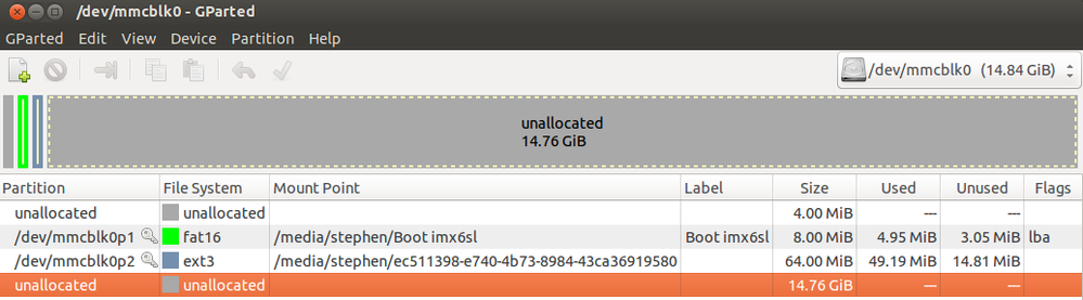

The partitions on the SD card dd'd from the .sdcard image, however, appear like this:
(with the uImage, dtb and ldo-dtb on the fat partition and u-boot *presumablly?* on the unallocated space just before the fat partition)
The latter arrangement is my experience with Yocto-generated images.  Partition 1 is a VFAT volume with a kernel ("uImage") and, in Dora builds, a compiled DTB file.  U-Boot reads the files directly.  Partition 2 is the ext3-formatted rootfs.
Schwab

stephenharper
This cleared up some of my partitioning questions. Thanks.
