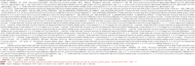

Hi NXP
We follow the "Linux 5.15.52_2.1.0​" Yocto Project User Guide.
Try compiler the imx8mplus demo image.
DISTRO=fsl-imx-xwayland MACHINE=imx8mp-lpddr4-evk source imx-setup-release.sh -b build-xwayland
bitbake imx-image-full
But we cat the compiler Error message:
ERROR: Task (/home/adv/adv-release-bsp/sources/meta-qt6/recipes-qt/qt6/qtbase_git.bb:do_install_ptest_base) failed with exit code '1'
Do you have any idea to fixed the issue?

pengyong_zhang
Hi @charleshuang
How did you solve this problem?
1,356件の閲覧回数
charleshuang
Senior Contributor II
sudo apt-get install git-lfs
2,111件の閲覧回数
coilnpark
Hi~~
I had the same experience.
You just update gcc version over gcc10~.
That is all.
2,134件の閲覧回数
Rita_Wang
How about the bellow setting, I just finished build success:
DISTRO=fsl-imx-wayland MACHINE=imx8mp-lpddr4-evk source imx-setup-release.sh -b build-wayland
