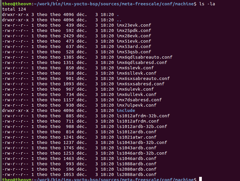

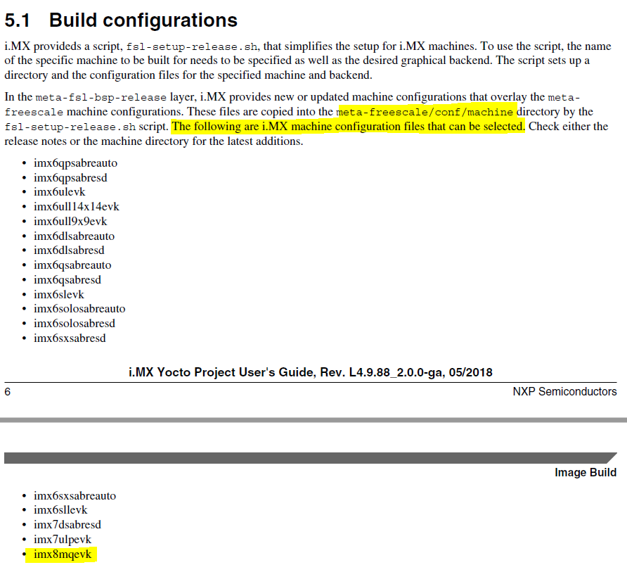

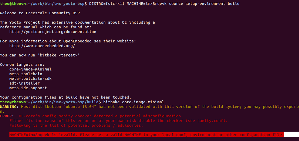

When following "i.MX Yocto Project User's Guide" instructions on how to setup Yocto repo and build an image, after setting up my host machine and trying to build an image, the machine  "imx8mqevk" is not recognized by Yocto as an available machine.
I checked the folder where all the machines are listed and indeed no conf file for imx 8 m SOM. I tried repo sync but still, no update solved the problem. Any clue?

what bsp version do you use? did you build successfully before set the build configuration?
5,233 Views
theophileleroy
bsprelease i.MX Linux Yocto Project BSP 4.9.88-2.0.0_ga Release
No, I didn't build succesufully beofre setting up this conf.
5,233 Views
bryanthomas
I don't think 18.04 is support. Please see release notes. Not that this is the issue, but it will lead to a bunch of other issues because of compiler versions.

bryanthomas
no issue building on 16.04
5,233 Views
theophileleroy
Will try with 16.04 LTS and keep you inform.
