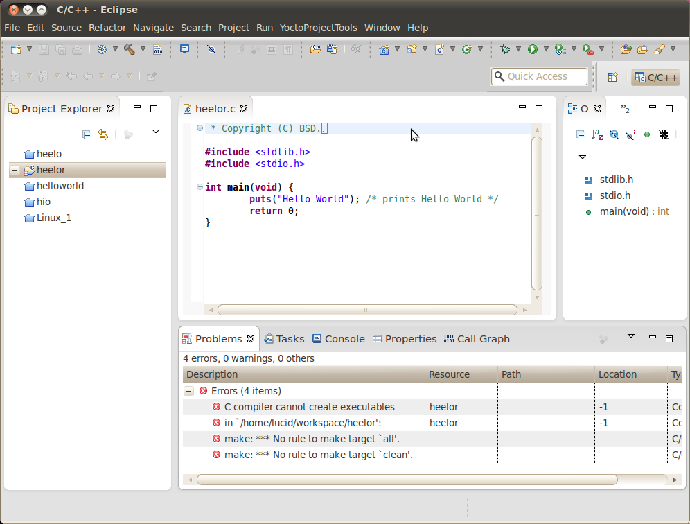

In doing so I typed the commands bitbake adt-installer then the log showed that it had succeeded.
So I found the ADT installer tarball in /build/tmp/deploy/sdk
Extracted that to a folder in my ~/. then I ran the adt-installer script. I didn't change the configuration.
That installed files to /opt/poky/1.3/.
From there I should have been set to use the eclipse yocto plugin.
In order to set up Eclipse and the Yocto plugin I followed these directions: http://www.yoctoproject.org/docs/1.3/dev-manual/dev-manual.html#adt-eclipsehttp://www.yoctoproject.org/docs/1.3/dev-manual/dev-manual.html#adt-eclipse
I went with Juno and I installed the pre-built yocto plugin (I thought it would be the safest).
After everything was installed, and two restarts later... I went into window -> preferences -> Yocto Project ADT
This window let me set where my toolchain was being pulled from.
I entered /opt/poky/1.3/ into both the toolchain root and the sysroot.
In the drop down I'm suppose to select my toolchain.
Here is where I found out I should have changed the adt install scripts configuration.
It only showed that I could select either ARMv5te or i586.
Obviously I screwed up. But I should be able to build using this toolchain. So I started a new project as the directions state.
I build the project and it gives me this output:
Okay so I messed up the ADT install. Turns out the configuration built for the wrong platform.

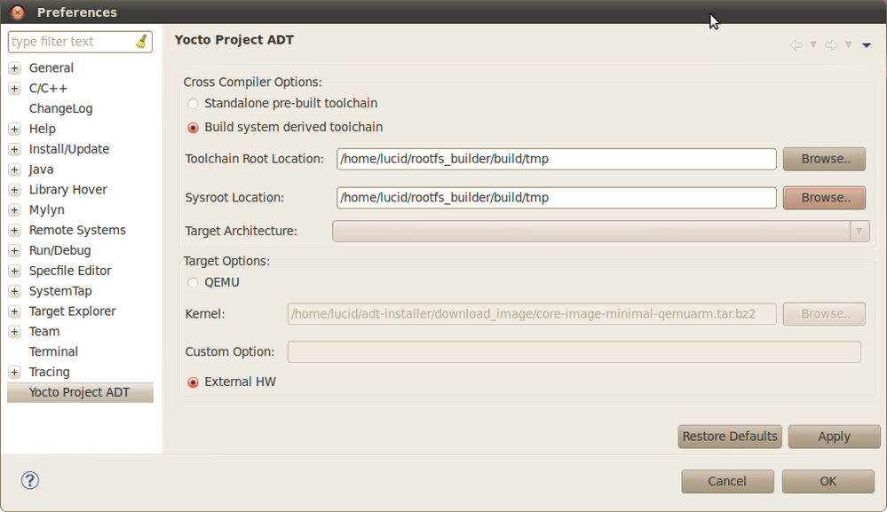

So then I tried to redirect eclipse to use my build derived toolchain.
So I entered in bitbake: bitbake meta-ide-support
It completed successfully and I saw a sysroot folder and an environment-setup file be placed in the /build/tmp directory.
So I go back into the eclipse and I I reconfigure it for a build derived toolchain.
But nothing appears in the toolchain drop down.

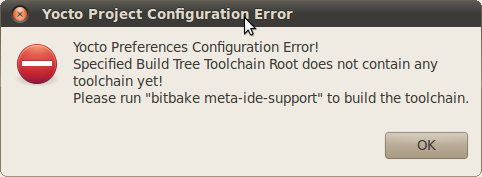

If I try to hit ok, even though my target arch is greyed out I get this.

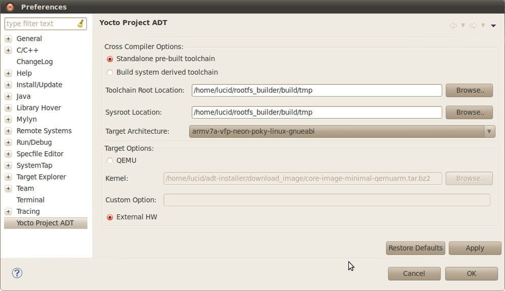

Here is the weird part, if I select standalone pre-built I get a toolchain in the drop down.
However, I can't select apply or ok.
That said, I'm not sure what else I can do to get the Yocto plug in to work.

OtavioSalvador
Senior Contributor II
I am sorry but I don't. We have customers using it in their customized BSPs so it works fine for all us.
The Eclipse error about meta-ide-support might be because it does not know where your build system is locate. I never used it this way as we build the toolchain for the customers and they use it with Eclipse but I'd try to open Eclipse from same terminal you did the environment setup to bitbake (after sourcing it).
