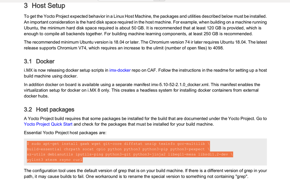

I have never gotten this kind of error. My proposed solution was for the issue  "server certificate verification failed. CAfile: none CRLfile: none", subject of this question.
I would suspect that the python version on your host machine is not good (i.e. python3 is missing). Please setup you host machine according to the IMX_YOCTO_PROJECT_USERS_GUIDE.pdf included in every BSP release :
K
