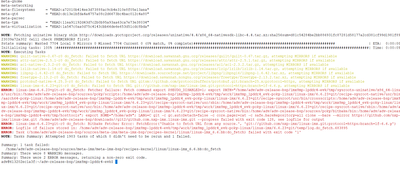

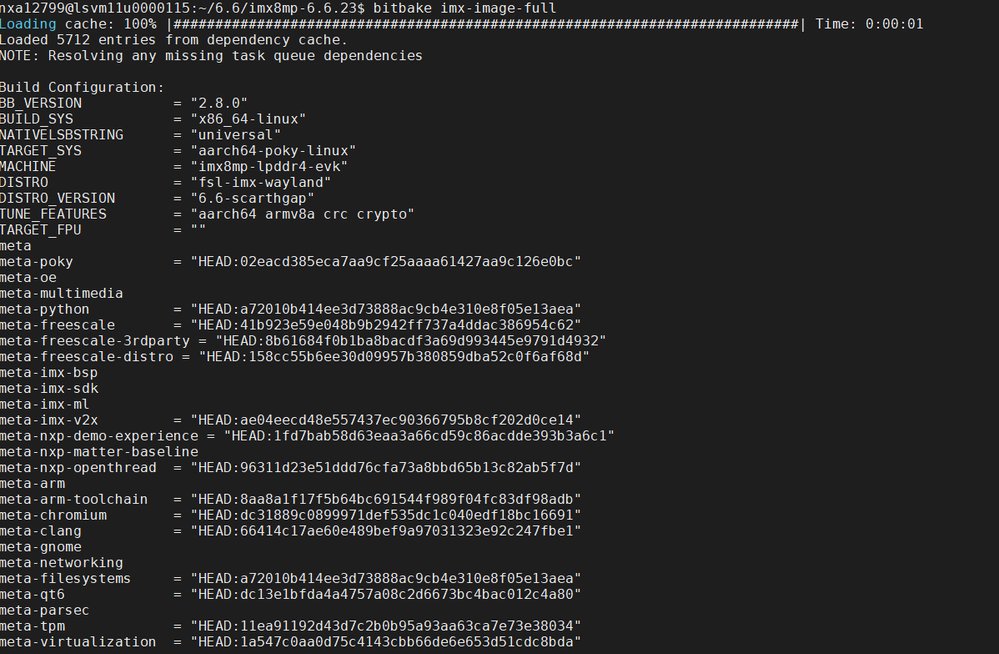

Follow nxp github readme.  Yocto 5.0 kernel 6.6.23 Yocto compiler fail in imx8mp.
https://github.com/nxp-imx/imx-manifest/tree/imx-linux-scarthgap
MACHINE=imx8mp-lpddr4-evk DISTRO=fsl-imx-xwayland source ./imx-setup-release.sh -b imx8mp-lpddr4-evk
bitbake imx-image-full
Do you have any advice?

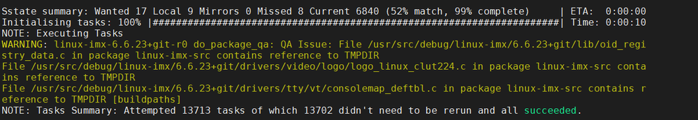

What is the Ubuntu version are you using? It is the host machine configure root for the compile failed, in our side, we do not met the issue.
Here recommend you to check and install all the Yocto Project host packages in the IMX_YOCTO_PROJECT_USERS_GUIDE

I got the other Error shark "nnshark_2023.11.imx.bb:do_configure failed ...."
Since the Yocto 3.3, we and our customer always get the fail message about nnshark.
Please provide the nnshark on downloads for Yocto 5.0.

Hi  @Rita_Wang
Our ubuntu is 20.04, we user the docker.
We have solutions about fixed the nnshark fail issue.
Thanks for your help.
