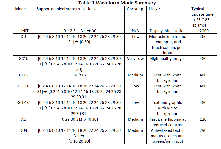

xrz_lam
Hello,Peter,
     I found the new waveform file(5bit) supports some update modes:
   Do we support all modes?
Thanks very much in advance.

xrz_lam
Dear Peter,
   I found in "hardware/imx/mx6/libgralloc_wrapper/framebuffer.cpp",it only had below define:
define WAVEFORM_MODE_INIT                      0x0   /* Screen goes to white (clears)*/
#define WAVEFORM_MODE_DU                        0x1   /*  Grey->white/grey->black*/
#define WAVEFORM_MODE_GC16                      0x2   /*  High fidelity (flashing)*/
#define WAVEFORM_MODE_GC4                       0x3
#define WAVEFORM_MODE_ANIM                      0x4   /*  animation*/
so,we only support these modes?Do you have any patch for support other modes?

xrz_lam
Hello,Peter,
   Now our BSP version is : android-13.5.0-ga.01;
   And the update modes are :INIT,DU,GC16,GC4,ANIM.
