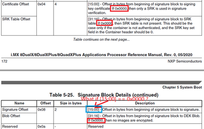

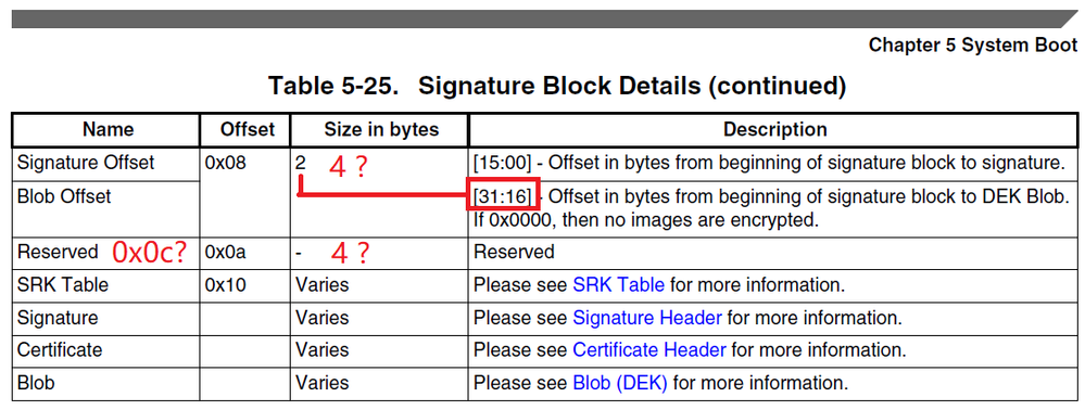

Wrong offset and size of signature block in imx8 RM rev0
And BTW, it's better to upload imx_mkimage source to github, since no enter found to fire issue on CAF.
e.g. -extract argument is not works and not documented in current version of imx_mkimage.

And missing 0x0000 comment on Signature Offset, like in SRK_TABLE/Certificate/Blob

Is there any update? 2 weeks.
And maybe this SEC521R1 is incorrect too in Table 5-31 SRK Record (continued), page 179, RM Rev.0

  I've sent You some comments directly.
