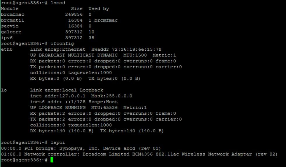

We have a problem that installed driver "brcmfmac.ko" and "brcmutil.ko" , but no wlan0 interface for ifconfig command.
We have a  broadcom wireless pcie module (BCM 4356) . The kernel version is 4.14.87-axl-1.0.0. The processor is imx8mq.

Hi hank
kernel version 4.14.87-axl-1.0.0 is not supported by nxp, one can try nxp linux
from linux-imx - i.MX Linux kernel   repository
Documentation
i.MX Software | NXP
and try to follow sect.4.13.7 Configuring WLAN from User Space attached Linux Manual.
igor
