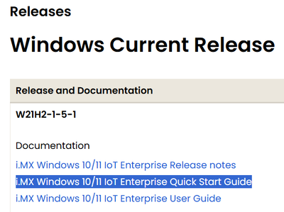

The download links on your site show the BSP supports Windows 10 & 11:
But the Quick Start & User Guide only contain instructions on how to build Windows 10. Now surely, your team must have built Windows 11 to make the claim that the BSP supports Windows 11, right?
My question is super simple; do I need Windows 11 SDK/ADK/WDK to build Windows 11 using your BSP or not? It should not be a difficult question to answer if the team tried it once. And if they did, why didn't they simply update the PDFs with their findings?
