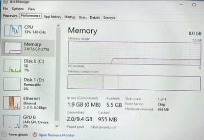

Hui_Ma
We would recommend customer to check the setting according to attached patch file.
And please also refer below config for a stable 8GB RAM as reference:
mu_platform_nxp/NXP/MX8QXP_MEK/Drivers/SmbiosPlatformDxe/SmbiosPlatformDxe.c
// Memory device
STATIC CONST ARM_TYPE17 mArmDefaultType17 = {
    { // SMBIOS_STRUCTURE Hdr
      EFI_SMBIOS_TYPE_MEMORY_DEVICE, // UINT8 Type
      sizeof (SMBIOS_TABLE_TYPE17),  // UINT8 Length
      SMBIOS_HANDLE_DRAM,
    SMBIOS_HANDLE_MEMORY, //array to which this module belongs
    0xFFFE,               //no errors
    0xFFFF, // unknown total width
    0xFFFF, // unknown data width
    0x2000, // 8GB
 Below is the test result:
Wish it helps.
