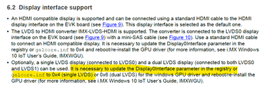

Hello, I have a board with 8MP CPU and 4G DDR. I can boot to the screen below. But LVDS has no screen to display WinPE.
And follow user guide, I enable lvds0 in galcore.inf to 0x4.
Do you know where I need to modify the code for lvds0 only output?
Note: I tested my lvds panel, it can work on 8MP EVK board thought  mini-SAS to LVDS Panel. I thought my LVDS panel can work on Windows 10 IoT Enterprise.

Hi @hankwang,
I hope you are doing well.
->Use a standard HDMI cable to connect an HDMI-compatible display. It is necessary to update the Display0Interface parameter in the registry or galcore.inf to 0x4 and reboot/re-install the GPU driver (for more information, see i.MX Windows 10 IoT User’s Guide, IMXWGU)
->A single LVDS display (connected to LVDS0) and a dual LVDS display (connected to both LVDS0 and LVDS1) can be used. It is necessary to update the Display0Interface parameter in the registry or galcore.inf to 0x4 (single LVDS) or 0x6 (dual LVDS) for the Windows GPU driver and reboot/re-install the GPU driver (for more information, see i.MX Windows 10 IoT User’s Guide, IMXWGU).

hankwang
Contributor V
Thank you for reply.
I changed the value to LVDS display and reflashed the windows image to sd card. But I still don't display LVDS Screen.
