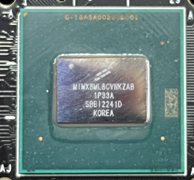

    We connected two RTL821F network ports using imx8mp, and now we have discovered an issue. Using an old router can obtain IPv4 IP addresses normally, while using a new router cannot obtain IP addresses and can only obtain IPv6 addresses and DNS addresses. Have you encountered similar problems. thank you!

   We use our own designed motherboard. The verification function of the motherboard hardware on Linux 5.10.52 is good.
    CPU version:
    Both network ports use RTL821F chips. The old router was bought 20 years ago and can obtain IP normally, but it is somewhat unstable under the TP-LINK brand. The new router was purchased from Huawei in 2023 and can only obtain IPv6 addresses and DNS, but cannot obtain IPv4 IP addresses。
