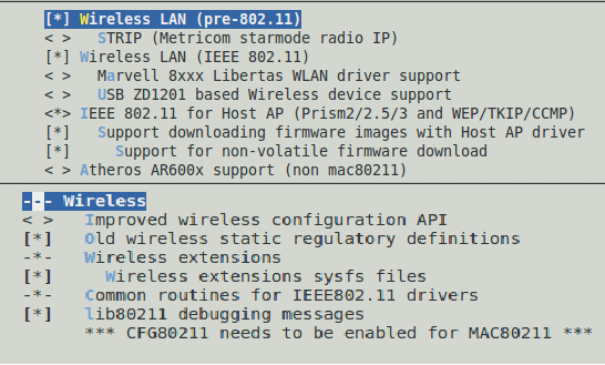

---using 'make menuconfig' command to configure kernel, and select wifi driver as [M], not [*].
---Selecting corresponding protocol module

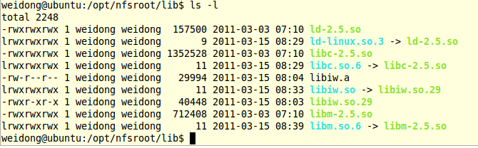

(1)downloading wireless-tools source from internet, I used wireless_tools.29.tar.gz , maybe you can get it's new version.
(2)compiling the tool, and get 7 binary files : iwconfig iwevent iwgetid iwlist iwpriv iwspy
[Note: don't forget to use ARM Compiler to compile the tool, not x86]

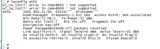

(3)using iwconfig to check eth1

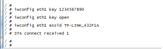

(4)using iwconfig command to configure AP
#iwconfig eth1 mode Managed(Note: before doing this, don't forget to configure Router(AP) as Managed)
#iwconfig eth1 key 1234567890
#iwconfig eth1 key open
#iwconfig eth1 essid TP-LINK_432F1A

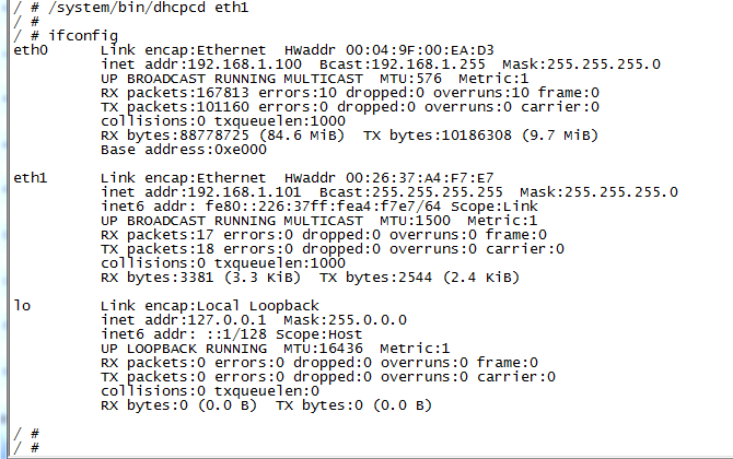

(5)Getting dynamic ip address by using dhcpcd command
#/system/bin/dhcpcd eth1

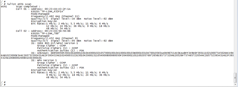

(6)Seaching AP by using iwlist command
#iwlist eth1 scan
