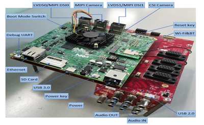

I have place order for imx8qxp mek board, while exploring it's user guide i could see Wi-Fi/Bluetooth module is not part of it. I have to port android 9 or above in mek. I could see the mek in android quick start guide with BT/Wi-Fi module but not clear which module is used.
Can you please guide me which Wi-Fi/BT module will be best suitable for imx8qxp?

Dear vipul Suneja,
For tested chips on Linux please take a look at Table 8. Supported features, p.18.
i.MX Linux Release Notes
For tested chips on Android please take a look at Table 3. Features, p.8 - 9.
Android Release Notes
Best regards.

As per the links shared, i could see BT/Wi-fi module NXP 88W8997(muRata LBEE5XV1YM) will work with imx8qxp-mek. I have explored different links but could see module is not available or lead time is 1 year. Can you please help me to get this module asap or any other alternate module which will work with imx8qxp-mek.
1,838 Views
JorgeCas
Dear vipul Suneja,
Unfortunately, we have this lead time and for now, those are the only tested and recommended Wi-Fi/Bluetooth chips for i.MX8QXP-MEK.
Best regards.
