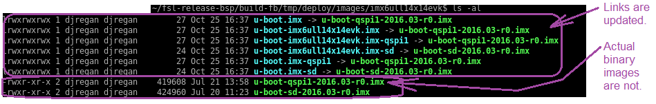

- While following 'i.MX_Yocto_Project_User's_Guide.pdf' subsection 5.5, and while changing preferences for U-boot image targets from 'qspi1' to 'spinor', we notice that /fsl-release-bsp/build-fb/tmp/deploy/images/imx6ull14x14evk are not updated with the U-Boot SPI-NOR preferences (for ECSPI Serial ROM boot option).
- I can confirm the last line within the 'conf/local.conf' file is UBOOT_CONFIG = "spinor"
- However executing statement $MACHINE=imx6ull14x14evk bitbake -c deploy u-boot-imx after updating the 'local.conf' file does not produce new files supporting the 'spinor' option.
My question is...
Why aren't new 'spinor' images showing up in /fsl-release-bsp/build-fb/tmp/deploy/images/imx6ull14x14evk/  ...image deployment folder?
I do see links to the u-boot binary images are updated / refreshed. But... actual u-boot binary images are not. See attached screenshot.

Hi Yuri, Thanks for the quick reply sir!
Unfortunately -> we can repeatedly run 'bitbake -c cleanall' ...and observe there is no change in outcome with the effort to run console $MACHINE=imx6ull14x14evk bitbake -c deploy u-boot-imx
Some additional information I can offer...
I just now (today) deleted my old '/fsl-release-bsp' folder and re-executed all necessary steps to recreate a new ''/fsl-release-bsp' folder and expected contents within this folder. I re-ran $MACHINE=imx6ull14x14evk bitbake -c deploy u-boot-imx ...and before changing the last line of file /conf/local.conf to support "spinor", I observe only a sd supporting u-boot imx image is produced (as expected),
After adding UBOOT_CONFIG = "spinor", and re-running $MACHINE=imx6ull14x14evk bitbake -c deploy u-boot-imx ...and, the resulting console output states: 'Tasks Summary: Attempted 234 tasks of which 234 didn't neet to be re-run and all succeeded." Meanwhile no new images are produced in the deployment folder.
Subsequently, after successfully building the default sd image, and unsuccessfully building the 'spinor' image, I revised /conf/local.conf to use the 'qspi1' targeted image, and reran $MACHINE=imx6ull14x14evk bitbake -c deploy u-boot-imx. This time - i see qspi supporting images show up in the deployment folder.

Sorry for re-replying to my reply from a few minutes ago... but... there's some new information that I just realized...
Revising UBOOT_CONFIG to be 'spinor' and running console command MACHINE=imx6ull14x14evk bitbake -c deploy u-boot-imx ...results in only a sd supporting image within the /tmp/deploy/images folder.
However, revising UBOOT_CONFIG to be 'qspi1' and running console command MACHINE=imx6ull14x14evk bitbake -c deploy u-boot-imx ...results in both a sd and qspi supporting u-boot image within the /tmp/deploy/images folder.
So... that's interesting? ...right? Ideas for 'where?' to look next?
