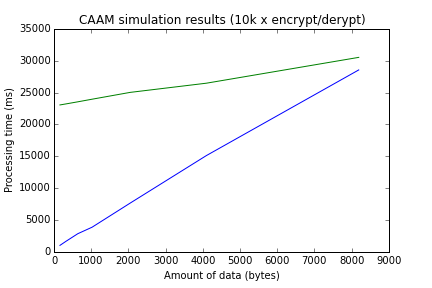

Hello again!
I have done a second experiment using the ablkcipher API (via tcrypt.ko).
To make this work I followed the procedure described here:
LKML: Stephan Mueller: [PATCH] kernel crypto API interface specification
Blue plot: reference results from synchronous blkcipher API using the SW AES implementation from the kernel (aes-generic).
Green plot: results for asynchronous ablkcipher API using CAAM (cbc-aes-caam)
(Numbers refer to 10k times encryption and decryption of data packages.
The size of a single package is given on the x-axis.)
What I see here confirms the previous observations from OpenSSL + AF_ALG.
For small package sizes the performance seems very poor. At approximately 8k we have break-even.
Would be really great to learn if this is the expected behaviour of the device.
Any feedback welcome!
Cheers,
Thomas

Hi Thomas,
Sorry for the late answer.
When I used the following kernel version 3.0.35_4.1.0, I got the following results with kernel crypto API (asynchronous interface): compared to SW, CAAM elapsed time becomes interesting starting from an input length >= 1MB. That is, for an input length equal to 1KB, 10KB or 100KB, CAAM has poor performance. By elapsed time, I mean the real time recovered with do_gettimeofday(). However, CAAM CPU time is smaller than SW CPU time starting from an input length >=100KB. CPU time is recovered using CPU cycle counters which are enabled by setting kernel CONFIG_HW_PERF_EVENTS. I think that CAAM is intended to be used for secure boot, software update and application layer cryptography. That is, CAAM can be used with applications that take a large input. However, it can not be used for network or transport layer encryption (smaller inputs).
In addition, I did some tests with kernel version 3.10.17, and I noticed that CAAM performance is improved for 1KB and 10KB inputs. However, it is still poor compared to SW.
Aymen

Hello Aymen,
thanks for sharing! That's fully in line with our observations.
Cheers,
Thomas
