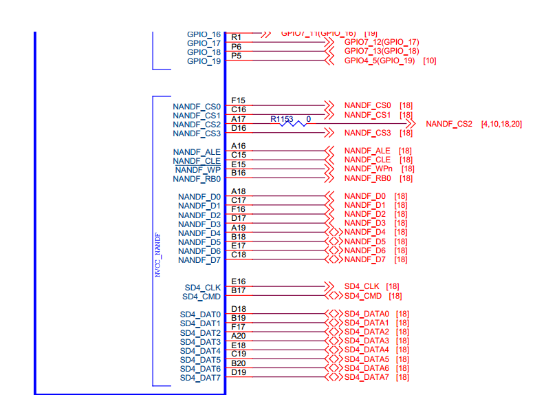

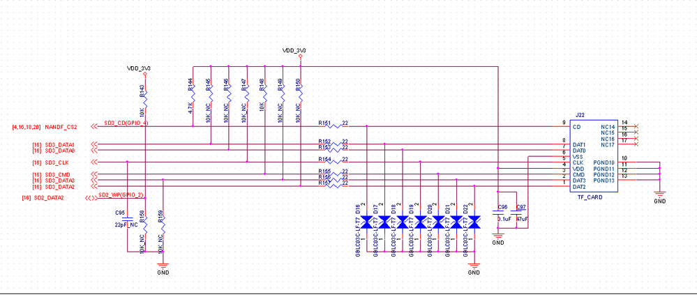

HI,
My board can not boot from 256MB nand flash when power on,and nand flash can run when boot from TF cards then manual command to run nand falsh.It looks like that the boot mode is somewhere wrong.The nand is W29N02GVSIAA.The following picture is my sch. and NC means not stuff.
The "NANDF_CS2" connects to TF card socket's CD pin to detect card insert,when insert TFcard,it boot from TF,when not insert TF card,it boot from nand flash.

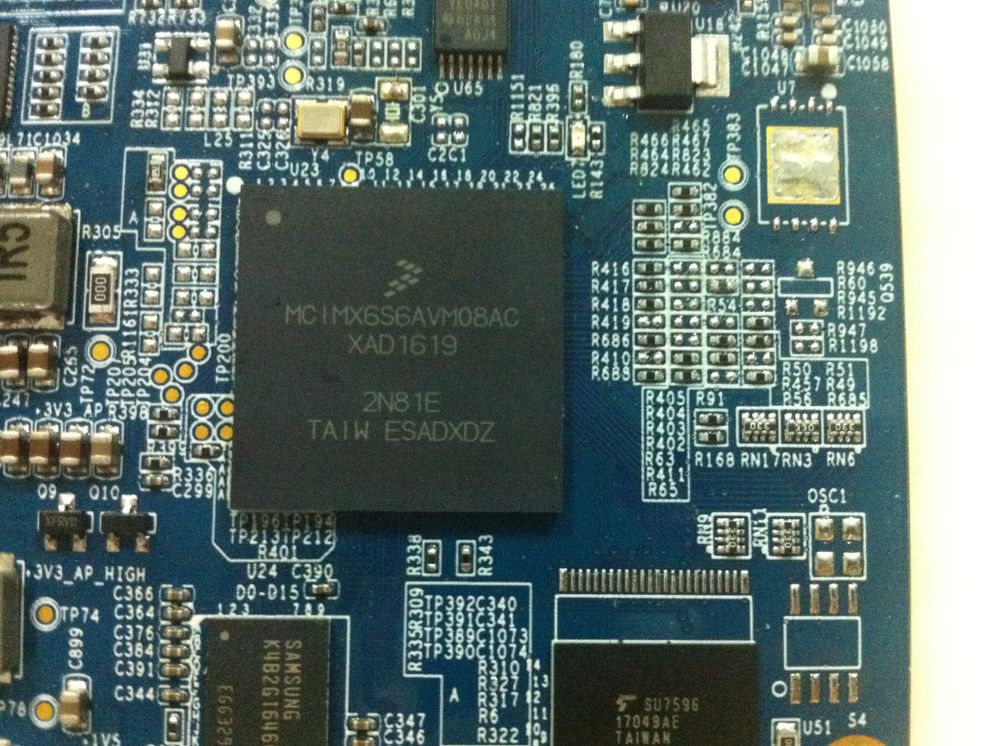

igorpadykov
Hi  翔李
what is full processor name used in the case ?
igor
3,633 Views
翔李
the part number is MCIMX6S6AVM08AC,the picture is following. also show the log of boot information from TF and tf manual command nand run.

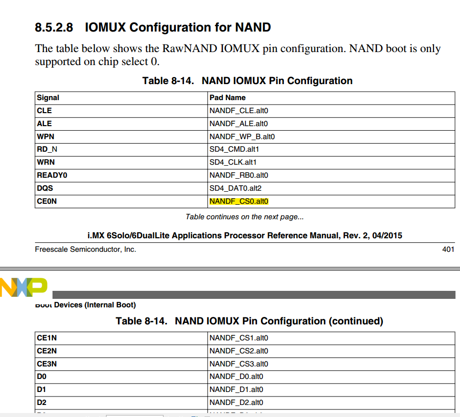

igorpadykov
hi
please refer to sect.8.5.2.8 IOMUX Configuration for NAND i.MX6SDL Reference Manual
http://www.nxp.com/assets/documents/data/en/reference-manuals/IMX6SDLRM.pdf
NAND boot is only supported on chip select 0.
general steps for debugging nand boot are given in
https://community.freescale.com/thread/307723
igor

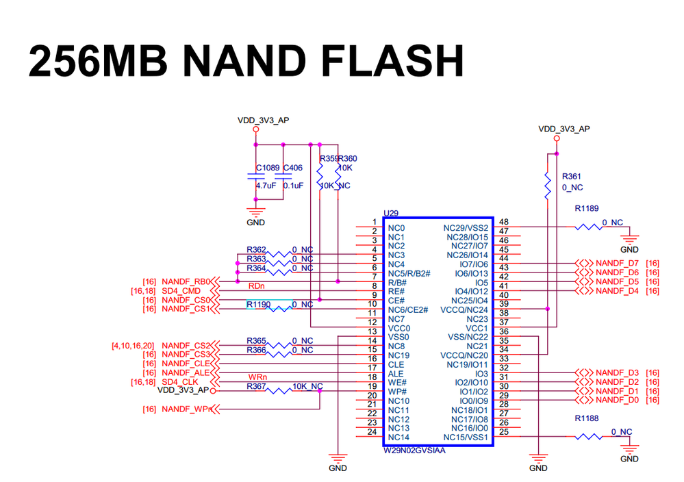

翔李
HI,
I already connect nand's ce# to NANDF_CS0 of imx6solo,it is ok.
So,I still do not find the problem.

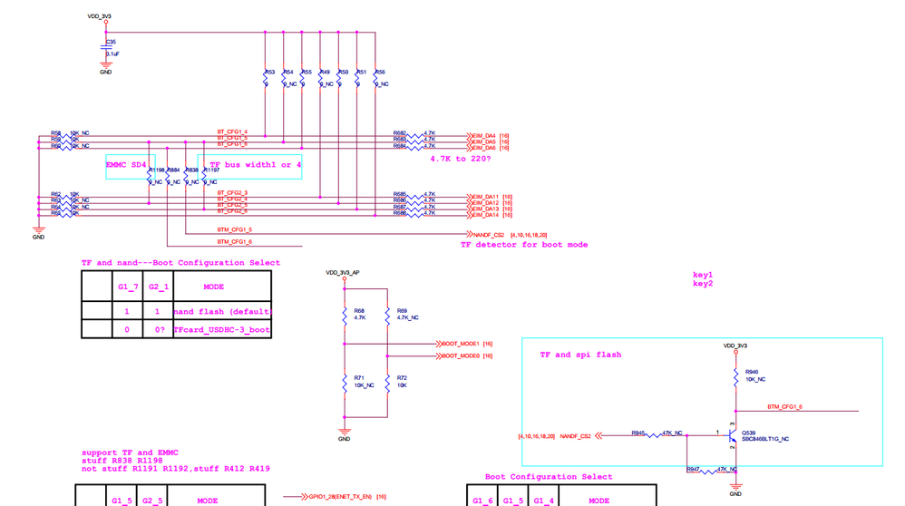

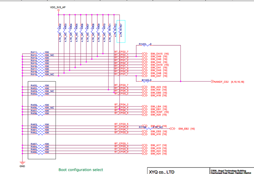

翔李
When I pull down the cfg1_4 from 1 to 0,my board can auto boot from nand flash.why?
and how do cfg2_4 effect nand boot?
3,633 Views
igorpadykov
cfg1_4 controls pad settings (affect drive strength and associated with them
signal integrity) defined in Table 5-7. NAND Boot Fusemap i.MX6SDL Reference Manual.

翔李
Thanks.
Now I can boot from nand flash when power up,imx6solo can read out the MFR ID and Device ID,but then fail to read ONFI ID(the read result is same as the MFR ID and device ID).why?My nand flash is W29N02GVSIAA.
can you give me the demo software of nand flash?
