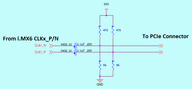

When I go through in Hardware design check list I could see following.

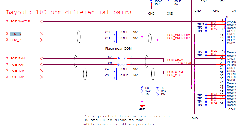

But when we refer Freescale Sabre SD board we can't see those changes. It should be both 470 Ohms and 56 Ohms pull up and pull down resistors for PCIE REFCLK.
In Freescale SabreSD board
In NXP iMAX6Q hardware design checklist.
1) Could you please explain why freescale is not using those changes ?
2) Why we need to use LVDS port for PCIE clock ? Is this a fault from NXP ? Any possibility to don't work or not getting stable PCIE link even without using recommended hardware settings (Pull up and pull down) ?
3) Why we use both pull up and pull down ?
Peter
reason is that Sabre board was developed in early development stage when not
all compliance tests were carried out.
PCIe module is gen2 compliant block but the clock is not coming out of this module.
seems this sets some voltage level which complies with sect.4.3.4.4. Receiver Specifications
PCI-Express base specification found on Specifications | PCI-SIG
igor

igorpadykov
Hi Peter
unfortunately documents are available only for members of PCI-SIG
association. In other words pull up and pull down set some voltage
within allowable range, defined by Table 4. Absolute Maximum Ratings
for Vin/Vout input/output voltage range i.MX6DQ Datasheet
and sect.4.3.4.4. Receiver Specification PCI-Express base specification.
http://www.nxp.com/docs/en/data-sheet/IMX6DQCEC.pdf
igor
