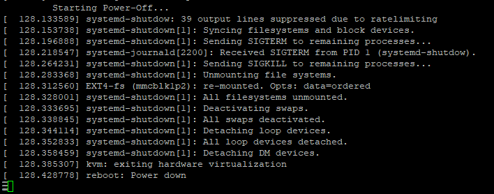

anaseem
Typing above command terminated communication with the PC console but power indication LED (D2) is still ON and fan is running?
