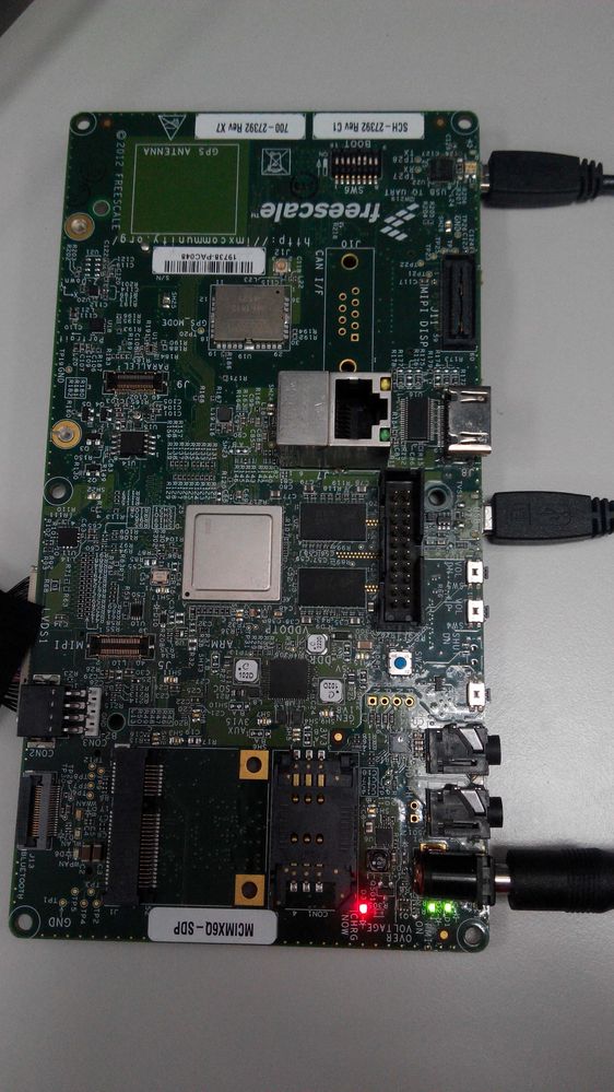

Hi all.
my configue
os ubuntu 12.04
kernel linux 3.0.35
board imx6q sabresd
I used sd-card boot system.
I need to use eMMC boot . So I change sw(1,2,4,6,7) and change cfg.ini below.
[profiles]
chip = MX6Q Linux Update
[platform]
board = SabreSD
[LIST]
name = SabreSD-eMMC
But Mfgtool2 is not work. "No Device Connected"
When change set sw (2,7) for sd card set , it is work.
I already change vid and pid same my PC .
But same not work...

Hi Hanseung Lee,
I see your environment as follows. The default boot is boot up from SD card.
my configue
os ubuntu 12.04
kernel linux 3.0.35
board imx6q sabresd
Here you want use eMMC boot, first thing you need to download the images to the EMMC by the mfgtool.
1\ Connect your board to PC, open the Serial such ad puty.exe
2\Copy the images to mfgtool file, if you are using the board from our company so you can use the default images
3\Configure the configuration file cfg.ini, download to emmc configuration are as follows:
[profiles]
[platform]
board = SabreSD
[LIST]
name = SabreSD-eMMC
4\Change the boot mode on board SW(5,6) ON for downloading.
5\Run MfgTool2.exe
6\Give power to the board,  "HID-compliant device" device detected then press the "Start "button to dowload.
Hope this can help you.

Rita_Wang
Hi Hanseung Lee,
Downloading mode you can see in the picture. When you finish downloading and boot from emmc, you also need to change the boot mode to boot up from emmc Sw(11010110 low to high).
Dan

hanseunglee
Thank you for your answers.
I think your suggestion really same my set.  But it not work. OTL...

hanseunglee
Hi Dan wang.
Yes ! I am success.
That problem is set boot switch.
For downloading image to emmc , do not  set boot switch 11010110(1,2,4,6,7)!
11010110(1,2,4,6,7) boot sw set is just for booting, not writing.
