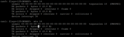

Dear NXP,
I run ifconfig -a ,and check can0 / can1 . It only found can0 . Why can't find can1 ?
Do I need to modify the code ? Please tell me how to find can1 .
SW version:5.10.9-1.0.0
15 回复数
7,159 次查看
t2865k5
Dear NXP,
I update your imx8mp-evk-flexcan2.dtb to test . It can recognize can0 and can1. May you provide the original
device tree (imx8mp-evk-flexcan2.dts) to me?

Juan-Rodarte
Checking the release notes, by default flexcan2 is disabled, to enable it you must add the imx8mp-evk-flexcan2.dtb
I share the document with you for reference
https://www.nxp.com/docs/en/release-note/IMX_LINUX_RELEASE_NOTES.pdf
Diego.

7,218 次查看
t2865k5
Dear NXP,
I modify the imx8mp-evk.dts but use ifconfig -a,
Still can't find can1.Please tell me how to modify it.
Please refer to my modification as follows:
&flexcan2 {
pinctrl-names = "default";
pinctrl-0 = <&pinctrl_flexcan2>;
xceiver-supply = <&reg_can2_stby>;
pinctrl-assert-gpios = <&pca6416 3 GPIO_ACTIVE_HIGH>;
status = "okay";/* can2 pin conflict with pdm: gpio low select pdm, gpio high select can2 */
pinctrl_flexcan2: flexcan2grp {
fsl,pins = <
MX8MP_IOMUXC_SAI5_MCLK__CAN2_RX 0x156
MX8MP_IOMUXC_SAI5_RXD3__CAN2_TX 0x156

t2865k5
Dear NXP,
pass:
ip link set can0 type can bitrate 125000 triple-sampling on
fail:
ip link set can1 type can bitrate 125000 triple-sampling on

Juan-Rodarte
You need to add the can1 in the dts file, it shared the dts code that it already has.
https://source.codeaurora.org/external/imx/linux-imx/tree/arch/arm64/boot/dts/freescale/imx8mp-evk.d...
Then you must use this command in linux
