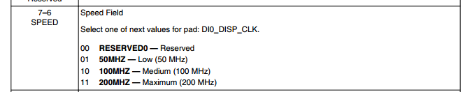

I see in e.g. the devicetree files for e.g. the SabreSD or Nitrogen6x that the pad control for all the relevant pins for the LCD parallel interface are set to 0x10. Why is that? It means that the SPEED field is set to 00 which is reserved according to the reference manual. Is there a particular reason, something I've overlooked or just an error..?

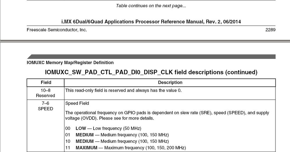

Hi ThomasG1z
setting Speed 00 LOW — Low frequency (50 MHz)
according to i.MX6DQ RM
igor

I see now that the documentation has been changed from the 2013 to 2014 version currently listed on your site. However for the i.MX6S/DL the reference manual on your web pages are still from 2013 and the speed field is documented like this:
But I assume the pad controls of the Dual/Quad are similar to Solo/Duallite so this field is not really reserved??
