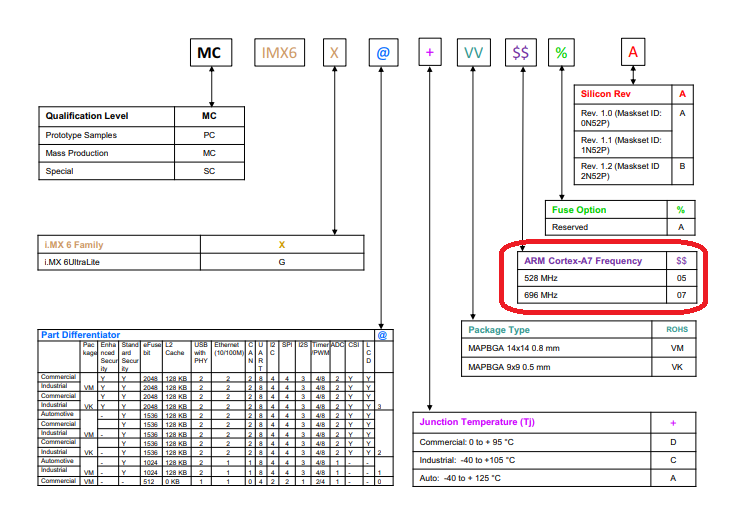

According to the product page of i.MX 6UltraLite Processor it operates at 696MHz but when I checked the datasheets of both consumer products and industrial products I found that all the part numbers operate at 528MHz ONLY?! Although
it is mentioned in the Part Number Nomenclature that there are 696MHz products!
Maybe future products?!
Could you explain this, please?

Hi Mahmoud
one can find them in Buy/Parameters tab (MCIMX6G1AVM07AB)
i.MX 6UltraLite Applications Processor | Single Arm® Cortex®-A7 @ 696 MHz |NXP
