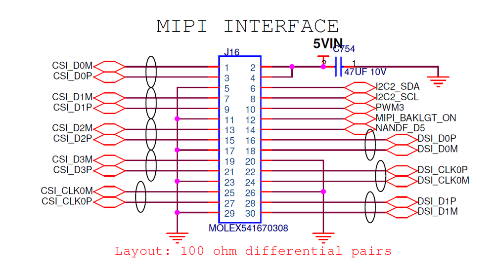

Okay, I looked around some more... The SOLO has only 2 data lanes so that ain't gonna cut it but the DUal does have 4 data lanes (800Mbit). So yea, I thought I will use the Mars board.. Well there is no MIPI connection on the board, and in the schematic of the board they weren't connected. Now I am considering the i.MX6 SABRELITE. Is this going to work with the ADV7280M?

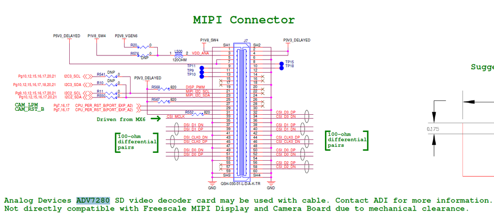

    >>Now I am considering the i.MX6 SABRELITE. Is this going to work with the ADV7280M?
(1)Yes, it is.
On i.MX6 SABRELITE board, MIPI connector is reserved for customer's expansion.
(2)Supporting ADV7280-M
On our sabreAI board, reserved a connetor for ADV7280M board,too. linux and android bsp both support ADV7280M.
so you can use Sabrelite board and ADV7280M

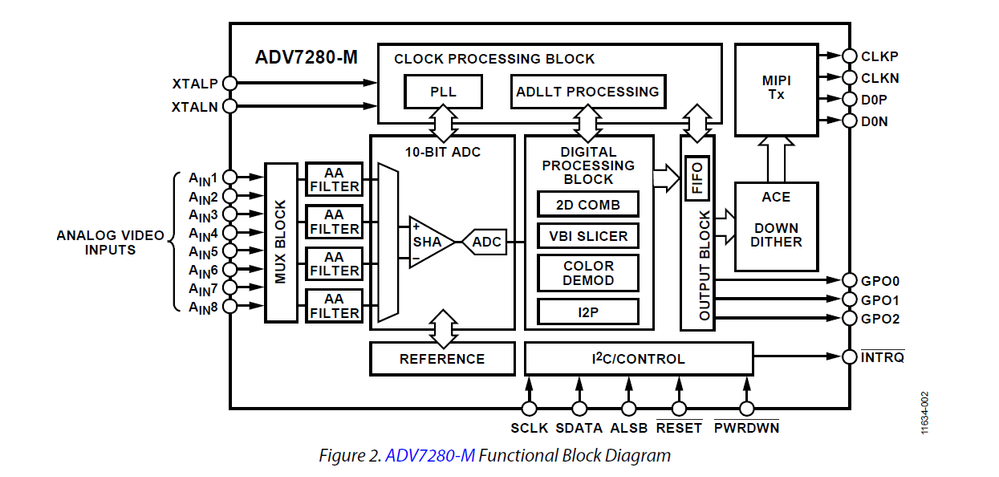

Hello,Maarten,
     I checked the datasheet of adv7280, even if there are multi channel video input, It can only handle one channel at same time ! you had better confirm it with ADI . See MUX BLOCK in the following diagram.
So maybe you can't use 4 channel video simutaneously.
Weidong
4,451 Views
tostikoning

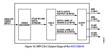

I come to the same conclusion when studying the ADV7280M Datasheet. I found the following:
And also the following: "The output of the ADV7280-M consists of a single data channel ..." Which suggest it is only possible to decode a single input.
Back to the drawing board...
