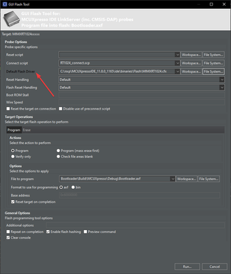

I am trying to use the MCU-Link with our i.MXRT1024 MCU in MCUXpresso IDE but when trying to debug I don't see any place where to set the Flash Driver, as I see when trying to flash using the GUI Flash Tool.
Here is where I set it when flashing using the GUI Flash Tool:
When trying to debug, I get the can't find a flash driver called '' error since I did not set the driver anywhere!
Is there a place to set the Default Flash Driver for the project or the workspace? This would be useful since even when using the GUI Flash Tool I must set it each time I flash.

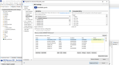

Anyway, I tried setting it in the project properties -> C/C++ Build -> MCU settings, in the table as you described here and it worked!
