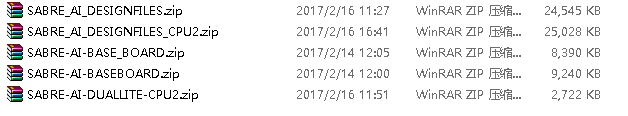

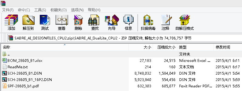

I am not sure Which sch for me to refer for designing imx6 solo is the best choice?
1:what is the difference between SCH-28605_B1.DSN and SCH-28605_B1_16P2 in 《SABRE_AI_DESIGNFILES_CPU2.zip》?Which sch, for me to refer for designing imx6 solo? Also in other SABRE zip.
2:what is the difference between SABRE_AI_DESIGNFILES.zip and SABRE_AI_DESIGNFILES_CPU2.zip?   SABRE-AI-BASE_BOARD.zip and SABRE-AI-BASEBOARD,zip?
also,what is the difference between 《SABRE-AI-DUALLITE-CPU2.zip》and 《SABRE_AI_DESIGNFILES_CPU2....SABRE_AI_DualLite_CPU2》?
985 Views
Yuri
Please look at my comments below.
1.
  File SCH-28605_B1_16P2 is in so called OrCad 16.2 format - it is more suitable
for importing for other CADS.
2.
SABRE_AI_DESIGNFILES is based on MX6 Quad Plus
SABRE_AI_DESIGNFILES_CPU2 - on MX6 Quad and Duallite
Yuri.

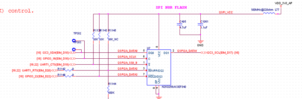

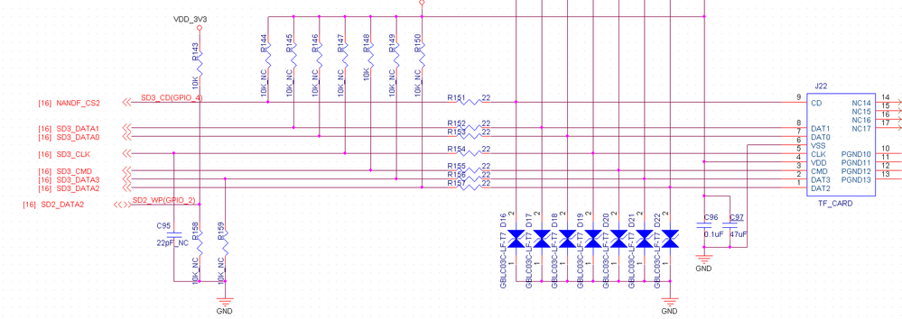

What's more,I did not find the boot mode list of imx6solo,where is the detail boot mode setting list,EIM_XXXX?
I am going to boot from 32MBYTE-SPI NOR FALSH orTFcard-SD2.
986 Views
Yuri
  Please refer to Table 8-20 (Serial ROM Boot eFUSE Descriptions) of i.MX6 S/DL RM.
Also, please use Table 8-23 (SPI IOMUX Pin Configuration) regarding pins using - looks
like - is OK in Your case. Note, QSPI is not supported by i.MX6 S/DL.
Yuri.
