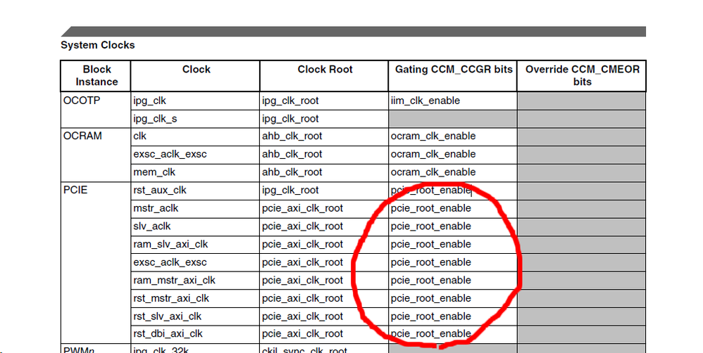

Hi all,
I want to use PCIe-RootComplex in RTOS on i.MX6.
Please let me know someone about the description of a document(IMX6SDLRM Rev. 1, 04/2013).
I cannot find pcie_root_enable described in the Page.800.
In which register is it?
And, is there any useful other document in order to operate PCIe-RC?
George

I checked the clock.c in the linux BSP. The clock gating for PCIe is CCM_CCGR4[CG0].

Thanks Jimmy,
