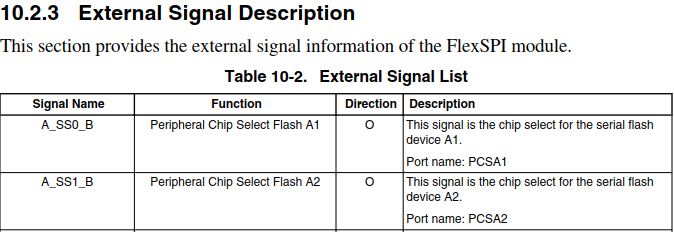

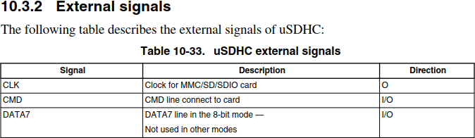

Like the table 10-2 for FlexSPI and table 10-33 for SDHC in reference manual.
