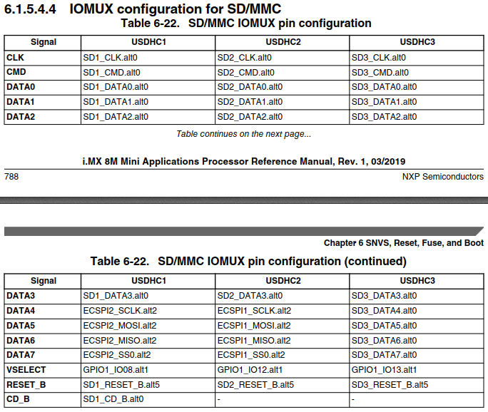

Where can we find the IOMUX pin configuration for boot from ECSPI1 of i.MX8M Mini?
Like the table 6-22 in i.MX8M Mini reference manual.

igorpadykov
Hi m.c.
one can check Table 62. Interface allocation during boot i.MX8M Mini Datasheet
i.MX 8M Mini Applications Processor Datasheet for Consumer Products
igor
