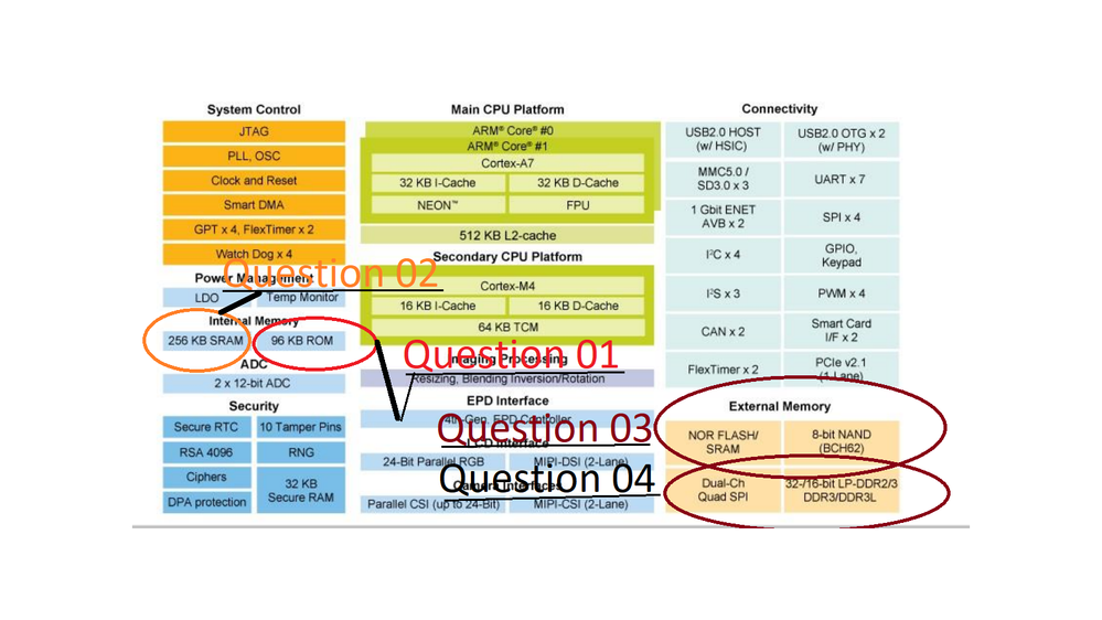

For physical address of your internal memory you can refer section 2.1.2 Cortex-A7 Memory Map of attached Reference manual for i.MX7D Application processor. for internal ROM starting address is 0x00000000 and for internal RAM (On-chip RAM) starting address is from 0x00900000.
For Q3 and Q4 (External memory):
You can refer the node of your external memory device from device tree files of your board.
