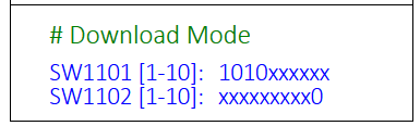

HI,i am using the imx8mm evk.
When i set the sw1101 1010xxxxxx,sw1102 xxxxxxxxx0,i execute the cmd:
 sudo ./uuu_imx_android_flash.sh -f imx8mm -a -e -t sd,the log is as follows:

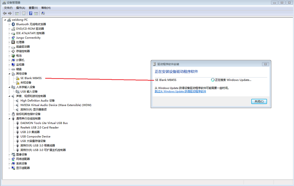

tangyuan
HI,sun
     I found that i power on the board, i can't find the HID compliant device.

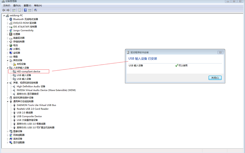

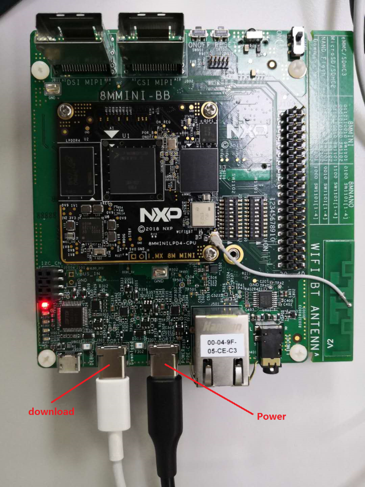

weidong_sun
Hi tang yuan,
According to schematic, your setting is no problem. But there are 2 USB Type-C connectors on i.MX8M Mini board, J301 and J302,  J302 is for power input, J301 is used for download purpose.  See test below:
1. connection
2. Connecting it to Windows USB Port
Then begin to install HID driver.
So no problem.

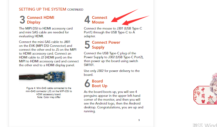

tangyuan
HI,sun
      Thank you very much for your answer!
      I see the official documents as follows:
      It said that the J301 is used for mouse! But i has a blank cable indeed as follows:
Can I use this cable to download!
2,557 Views
weidong_sun
Yes, the cable is correct.
One side is USB TYPE-C, the other side is USB TYPE-A-M.
weidong
2,556 Views
tangyuan
Thank you ,Sun,
 The problem is solved
