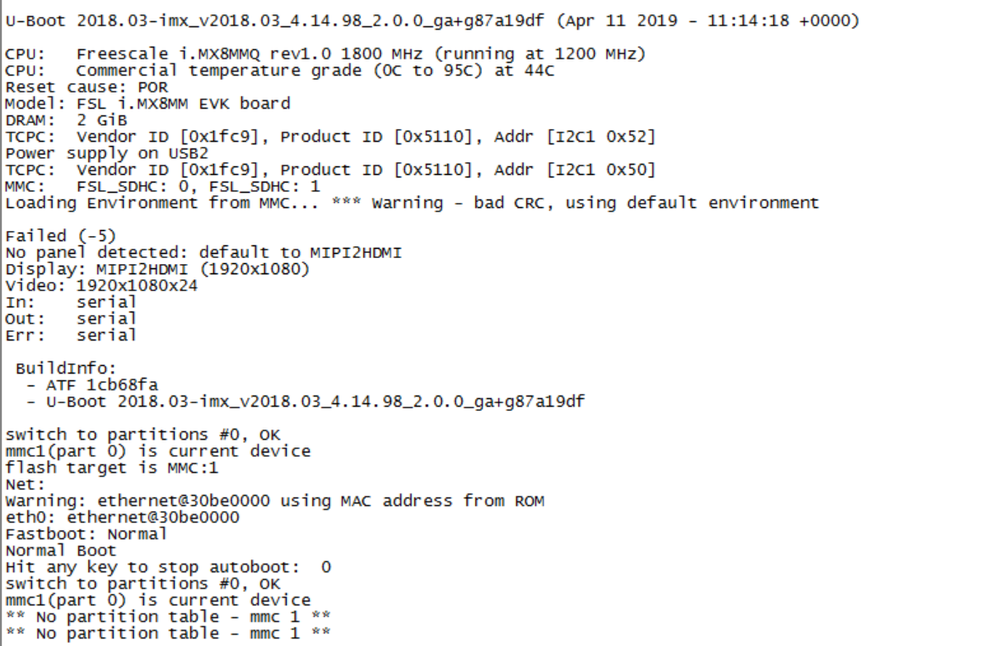

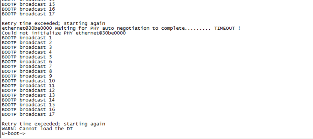

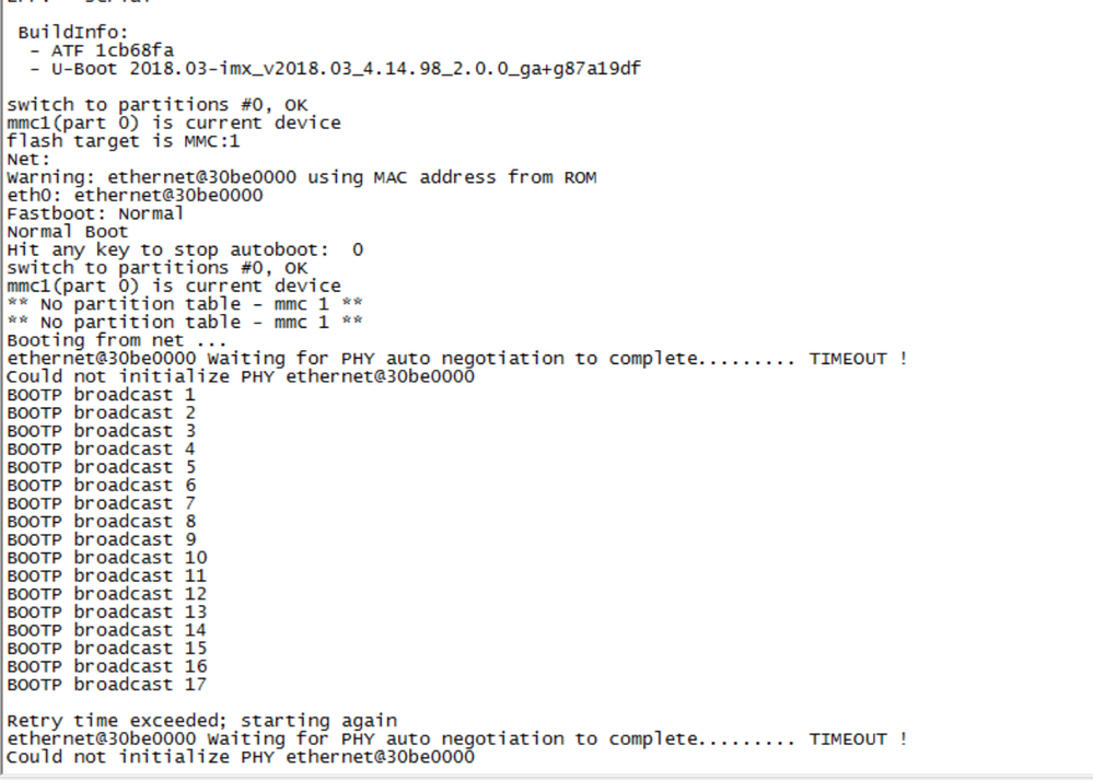

When i download the linux image to imx8mmini,the system cann't startup
1,542 Views
tangyuan

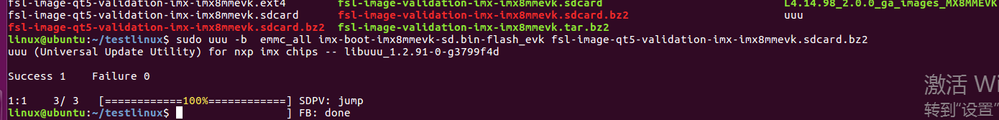

    When i download the linux image to imx8m mini,the system cann't startup
    The download command is as follows:
The system information is as follows:
Please ,help me !Thank you

igorpadykov
Hi tang
what board used in the case, if this is custom board first necessary
to run ddr test
i.MX 8M Family DDR Tool Release
and follow Chapter 4 How to bring up a new MX8MSCALE board MSCALE_DDR_Tool_User_Guide.pdf
included in ddr test package.
If this is EVK board follow Linux L4.14.98_2.0.0 Documentation
Linux Guide and use Linux Binary Demo Files - i.MX 8MMini EVK
igor

tangyuan
My board is imx8 mini evk.I don't know the reason!
