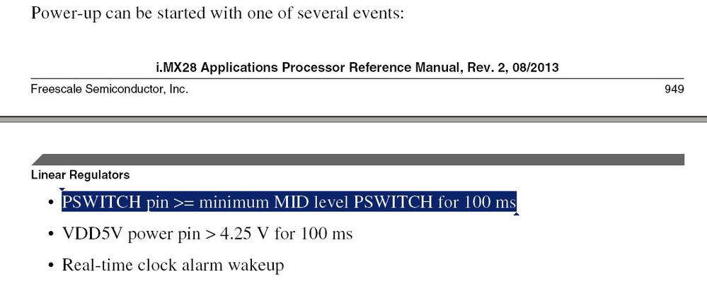

supplying about 1V to PSWITCH is one of methods for powering up processor
as described in sect.11.3.3 Power-Up Sequence i.MX28 Reference Manual
https://www.nxp.com/docs/en/reference-manual/MCIMX28RM.pdf
so if there are some problems with powering with "VDD5V", for example due to
insufficient value or ripples, one can use method with PSWITCH pin.
igor
