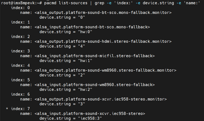

    When I tested the Bluetooth sink on the imx8mp, after executing pactl list sinks, there was no wm8960 sound card option. What should I do to enable this sound card option? After the board is powered on, the following printout is displayed. I have attached the specific dmesg log.
[ 3.269965] ALSA device list:
[ 3.272952] No soundcards found.
[ 7.035930] wm8962 2-001a: Failed to read ID register
[ 18.399955] platform sound-wm8962: deferred probe pending

Please confirm that you are using the correct DTB file, by default the demo image uses imx8mp-evk-revb4.dtb with sound-wm8960 disabled, you should use imx8mp-evk.dtb.
Run the next commands in U-boot and try again:
setenv fdtfile imx8mp-evk.dtb
saveenv
boot

Yes, your method worked. Then I disabled sound-wm8962 in imx8mp-evk-revb4.dts, and enabled sound-wm8960. There is also a wm8960 option. Thank you for your support.
