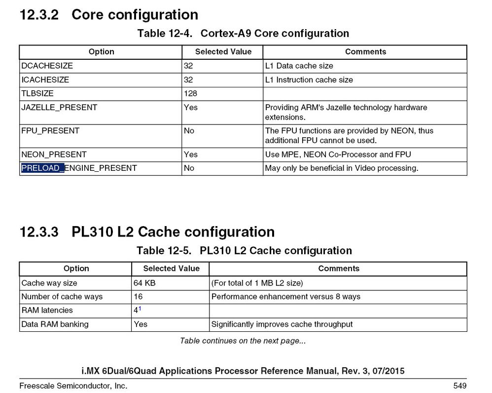

I found in <ARM Cortex A8 TRM (ARM DDI 0388F)>, section 4.3.30, <Preload Engine Parameters Control Register>, that "PLE wait states" (PLEPCR[7:0]) can be used to limit the usage of PLD instructions.
What's it's reset value or default value in IMX6 BSP? And where shall I place the code that changes it during boot process, in U-BOOT or kernel?

Hi Dehuan
Cortex-A9 processor is delivered as synthesizable RTL, please look at part of i.MX6DQ RM
igor
